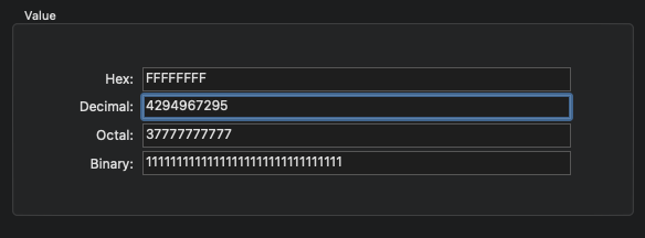

PlatformFeature should be set to the failsafe 4294967295 (0xFFFFFFFF)
Fixed, see #89. How do you calculate that, Hackintool gives same result for 0xFFFFFFFF and FFFFFFFF:
Btw, you can use "-1" instead of "4294967295". It applies for any "0xF ... F" value.
-1 is INT32 signed (see SetApfsTrimTimeout), 4294967295 is unsigned. I'm confused, the documentation states clearly to use the 0xFFFFFFFF value but it does not says if we should use signed or unsigned INT32:
Which one do we use @cdf, I need that calculator explanation. I opened #1543.
This is directly from Vit while coordinating with him on edits to the docs. Wraparound maths as he described it. I suppose explicitly calculated value as cdf did is clear.
On calculator, you can use the in built one in Mac OS.
Let's see what Vitaly answers on #1543. If that is the case, I will use -1 for uniformity reasons.
Can you show a calculator conversion screenshot example?
