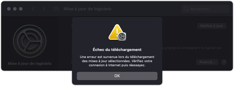

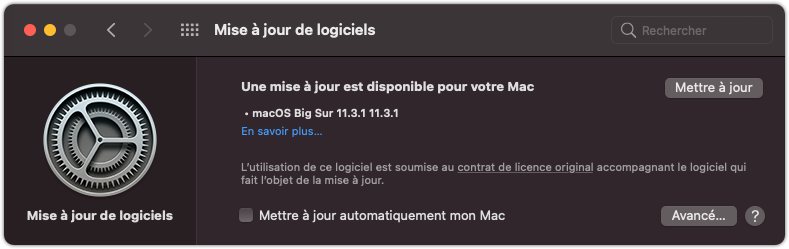

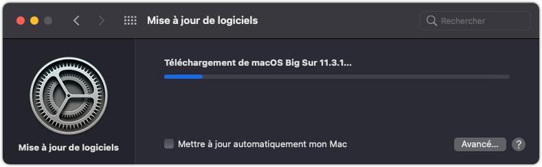

- mac sees update, but refused to even download it (see attached pictures) and make an error.
Update is available (strange double version number though)
Download seems to stop after few seconds
then makes an error - roughly translates to "download failed, check your internet connection"
Runnin low on solutions for these, i'll be glad to bring anything you could ask to help me 🙂
