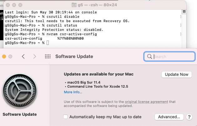

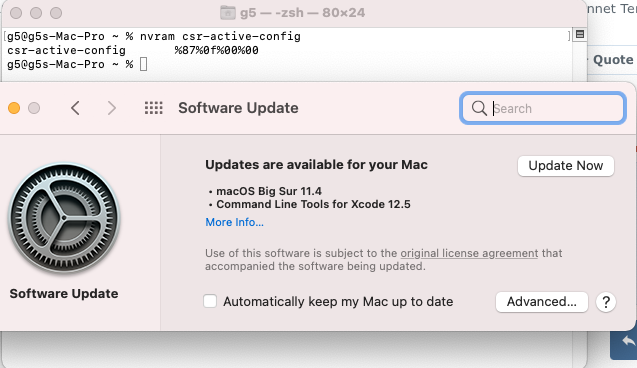

CSR_ALLOW_UNAUTHENTICATED_ROOT (0x800) is not practical as it prevents incremental (non-full) OTA updates.
I am using all the time 87F which includes 0x800 and I can update BS. Which update is prevented?
87F= csrutil disable + csrutil authenticated-root disable
Issued from recovery.
@startergo - thanks -
Please do confirm as requested: if you are getting OTA updates and especially incremental OTA updates then something is up and (I think) needs addressing. Thanks for your input.
I am getting OTA and incremental updates with 87F which is the Apple default SIP+authenticated-root in latest BS. When BS came out originally it was 877, but then it changed to 87F.
tyvm - yes, 0x77 for csrutil disable was the Catalina default, and it changed to 0x7F early in Big Sur, I agree.
I also tend to agree with you that my experience was that there was no issue with getting updates with 0x77 or 0x7F (although I've been using SIP enabled almost all the time for ages, so can no longer be quite sure; as I already had my own tool to quickly toggle SIP, before winning the case to be allowed to add something similar to OC), but I'm being told that cannot be so...
thank you for your input

TL/DR:
  • SIP bit 0x10 (present in 0x7F, 0x77, 0x87F etc., but not in 0x6F, 0x26F etc.) blocks OTA updates, period. (I have just replicated this.)
  • SIP bit 0x800 apparently blocks incremental OTA updates. (I would tend to trust this until proven otherwise.)
So @startergo I've closed the OC issue for now - if yourself or anyone else can provide screenshots similar to those I've just generated showing something other than the behaviour above, and as currently documented in the OC docs, I will happily examine.
Reactions: cdf

TL/DR:
Well, 0xF87 I would expect to offer an update anyway (possibly not an incremental update but that is not tested).
0x87F is a valid counterexample though, I agree. (And as mentioned in the issue, I have now found counterexamples too.)
Genuinely, thank you very much for your input - but I hope you're okay with the final decision (now publicly endorsed by Vit, ofc, too) that since these bits are known (incl. replicated by me yesterday) to cause problems on some systems, the warnings stay in, and the choice not to set them in our default value stays. (I gather that if you know enough about the internals of the update system, that you'd expect that they would cause problems - but I don't - at least so far.)
