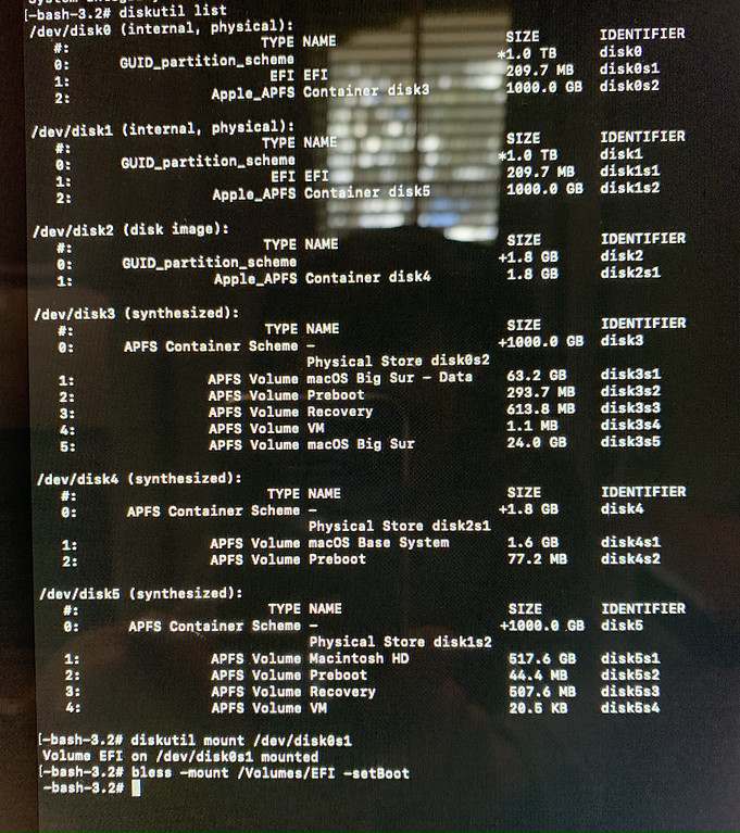

It seems to have worked with the following command:
disk0s1 is the one I needed to bless.
It took a little while to show up but it has booted and without the old HDD in. Just about to restart and double check.
Edit: Confirmed - it takes a while for the boot menu to appear but it does appear now and the old HDD is stored away. Thanks for the help. The SSD is in the second superdrive bay with an adaptor frame I had from an old PC build.
You can use the dumpallbootvars command from my gfxutil.sh script to see what the bless command uses for the boot variable.
https://gist.github.com/joevt/477fe842d16095c2bfd839e2ab4794ff
Usually I would include the --file option with the bless command to specify the bootx64.efi file.
sudo bless --mount /Volumes/EFI*/*bay2/.. --file /Volumes/EFI*/*bay2/../EFI/BOOT/bootx64.efi --setBoot
where bay2 is the name of a folder on the EFI partition in case I have more than one EFI partition mounted. My MacPro3,1 has 4 drive bays (plus two SATA ODD (optical disk drive) connectors and two PATA ODD connectors).
I wonder if native blessing from within OC without having to turn off RequestBootVarRouting might be a feature worth adding to OC for Macs that don't have the native boot picker. Perhaps @Bmju could comment on the feasibility of adding such a feature.

Blessing is just so easy when it can be done on startup by holding Option. Unfortunately, this option is usually unavailable on the classic Mac Pro. Of course, Recovery provides an alternative, but accessing Recovery natively can be nontrivial. It requires having a legacy version of macOS around, which needs to be set as the default boot entry in the first place!
Actually, can you remind me again what do your MacPro's have, for a pre-boot menu without OC? Just nothing at all? (I recall some v. old Macs have an Intel style EFI menu?) (And I think I recall you said there is something else you can install to give the MPs a menu, even without OC? Or no? Or only on some?)
With a standard graphics card, nothing at all. Installing @Dayo's RefindPlus will provide a menu, but I'm not sure if RP can be used to bless a boot entry, at least not without that entry booting through RP in the first place.
OC hides itself in the menu - so isn't the one thing you want to bless not there?!
Yes, it hides itself, but not other instances of itself. Perhaps this is a bug, but it has turned out to be very useful, because it allows us to use OC on a CD to easily bless a main installation of OC. Why a CD? Because a CD can be booted on demand by holding C, much like holding Option to bring up the boot picker, except that the latter is not available with a standard graphics card!

Hi @cdf @Dayo :
Code:
                <key>Tools</key>
                <array>
                        <dict>
                                <key>Arguments</key>
                                <string>disable</string>
                                <key>Auxiliary</key>
                                <true/>
                                <key>Comment</key>
                                <string></string>
                                <key>Enabled</key>
                                <true/>
                                <key>Flavour</key>
                                <string>NVRAMTool</string>
                                <key>Name</key>
                                <string>Allow Bless</string>
                                <key>Path</key>
                                <string>OpenControl.efi</string>
                                <key>RealPath</key>
                                <false/>
                                <key>TextMode</key>
                                <true/>
                        </dict>
                </array>
Boot entry. Flashes briefly. Temporarily allows bless until next boot. 😎
The fact that OC shows other OCs is a side effect of https://github.com/acidanthera/OpenCorePkg/commit/3ef3e17a3 - it should only happen between different versions on either side of that commit - so you might be back to blessing from Recovery, but hopefully at least booted via OC.
Reactions: cdf and Dayo
