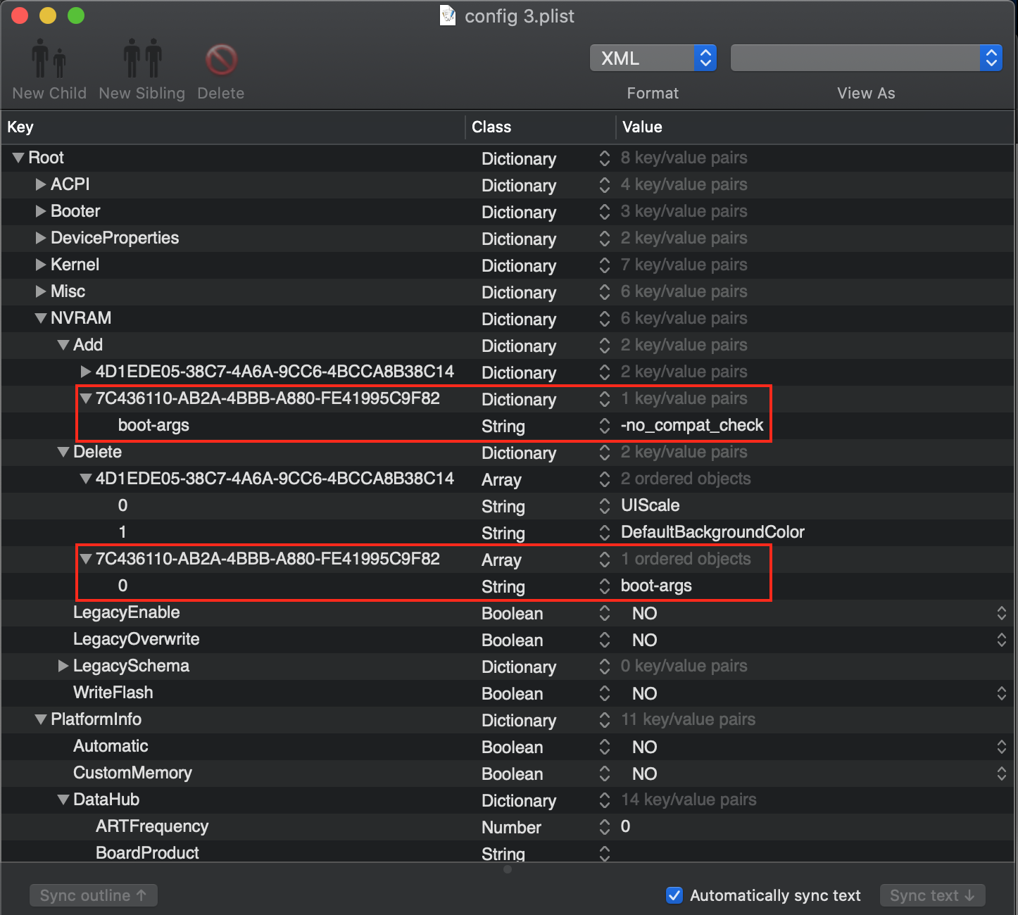

Not sure if you have mentioned where you derived your config.plist from, but it's missing a -no_compat_check boot-args setting in the NVRAM section:
Yup. That’s part of the HW Acceleration. See First Post in this thread, under “Advanced Config”.
What are the direct disadvantages of leaving the VMM flag constantly on? Let's assume I do not care about the 5 % performance loss.
If you want H/W Acceleration, then follow the guide in this post #1,314 by @h9826790. If you download the latest OC package in that post and examine the config.plist, you will notice -no_compat_check is added to NVRAM key 7C436110-AB2A-4BBB-A880-FE41995C9F82 even though that config is spoofing an iMacPro1,1 (so should not need that boot-arg). It's does not do any harm and may fix your issue.
