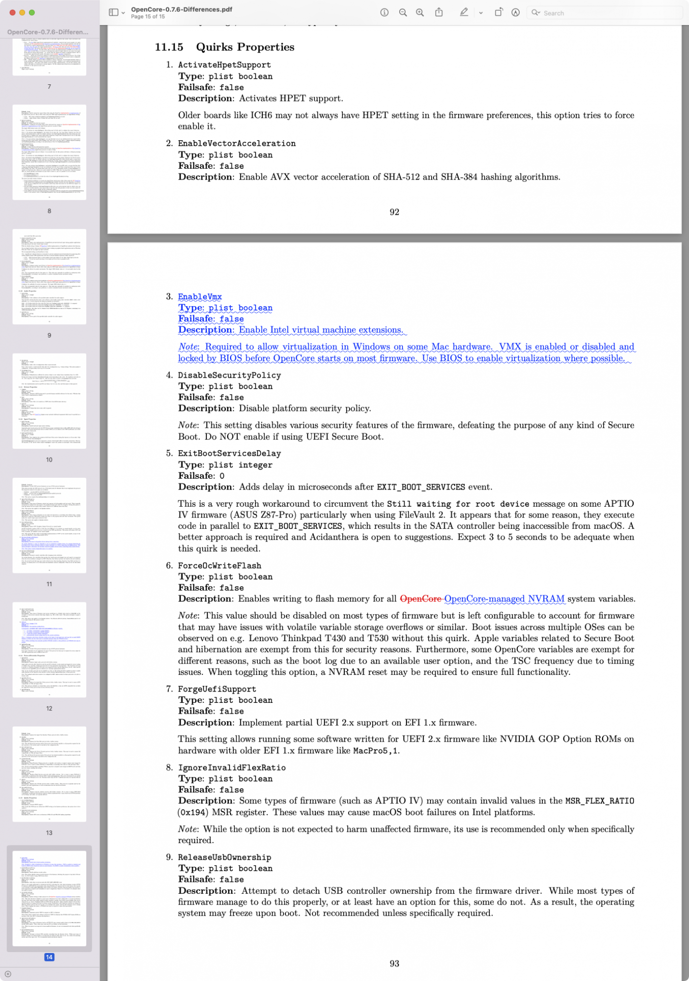

For the curious, you can view the Differences.pdf showing the difference between the OpenCore 0.7.5 and 0.7.6 Reference Manual here. Alternatively, find it included in the OpenCore-0.7.6-RELEASE download.
I've only been using OC for less than a month now, but I'm not seeing any changes that would appear to affect users with OC already installed and working on their classic Mac Pros.

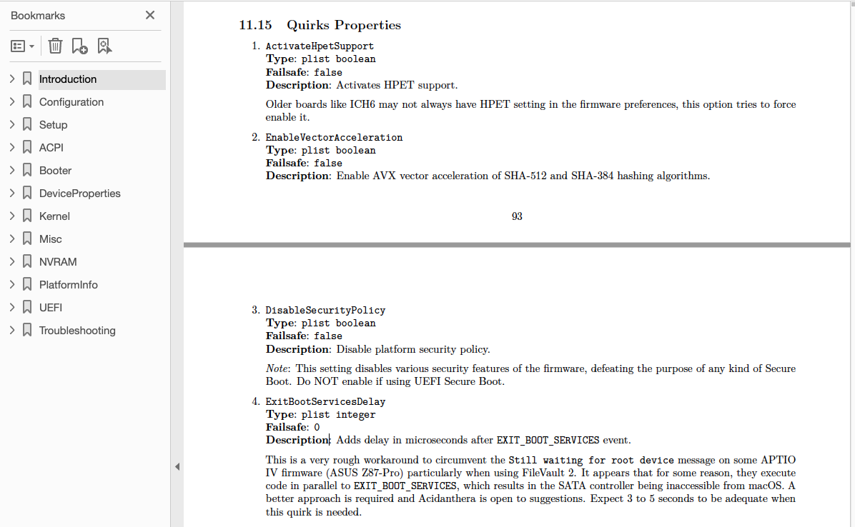

I may well have missed something, but the 0.7.6 OC Reference Manual doesn't mention an EnableVmx parameter. Is there a typo or something, or is that an undocumented feature?
Good observation. It's missing from the documentation that shipped with 0.7.6. However, it's included here:

Thanks. I'm sure those 0.7.6 changes you mention must indeed be in some document, but, quite certainly, there is no mention whatsoever to "EnableVmx" anywhere in the "Configuration.pdf" document (dated 2021.11.28) that came with "release" OC 0.7.6 I downloaded from the Acidanthera GitHub site last Monday. See here:
