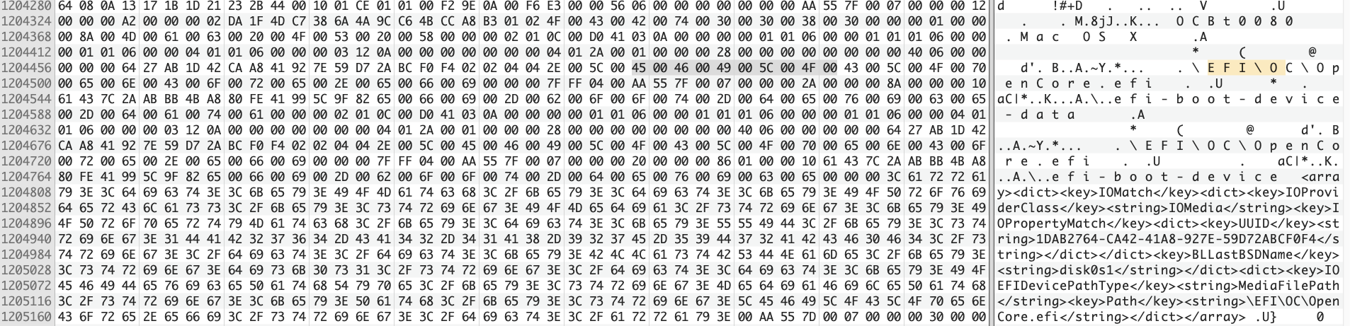

I guess I can answer to myself
it seems it's the presence of OpenCore.efi at first in BootOrder
any complains?
Reactions: MacOZzy
Yes, this is true if LauncherOption=Full, but I wonder if it might not also be true otherwise. For instance:

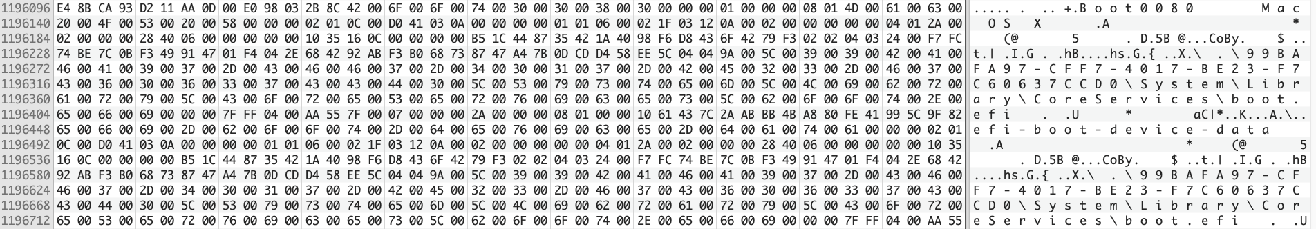

Does disabling LauncherOption after booting with it enabled change the Boot0001 entry?
yes, gets deleted, did that to compare on the same machine

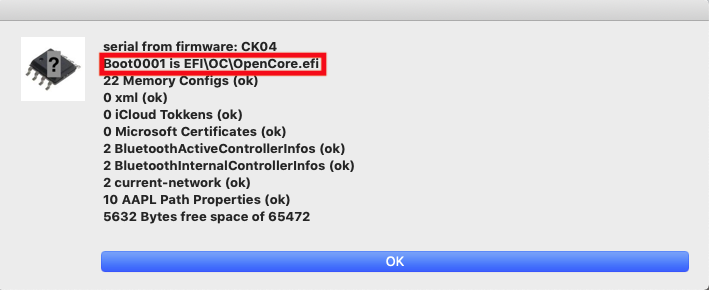

thanks a lot, I maybe have a simple solution
check the presence of EFI/OC/OpenCore.efi plus the presence of Boot0001 in the nvram part of the dump.
I scanned 200 plus firmware dumps and I don't got false positives. Even if I manually bless the file EFI/OC/OpenCore.efi it is Boot0080, not Boot0001
I need it simple because I want to detect things inside an OpenCore booted System and also directly from a rom dump file.
