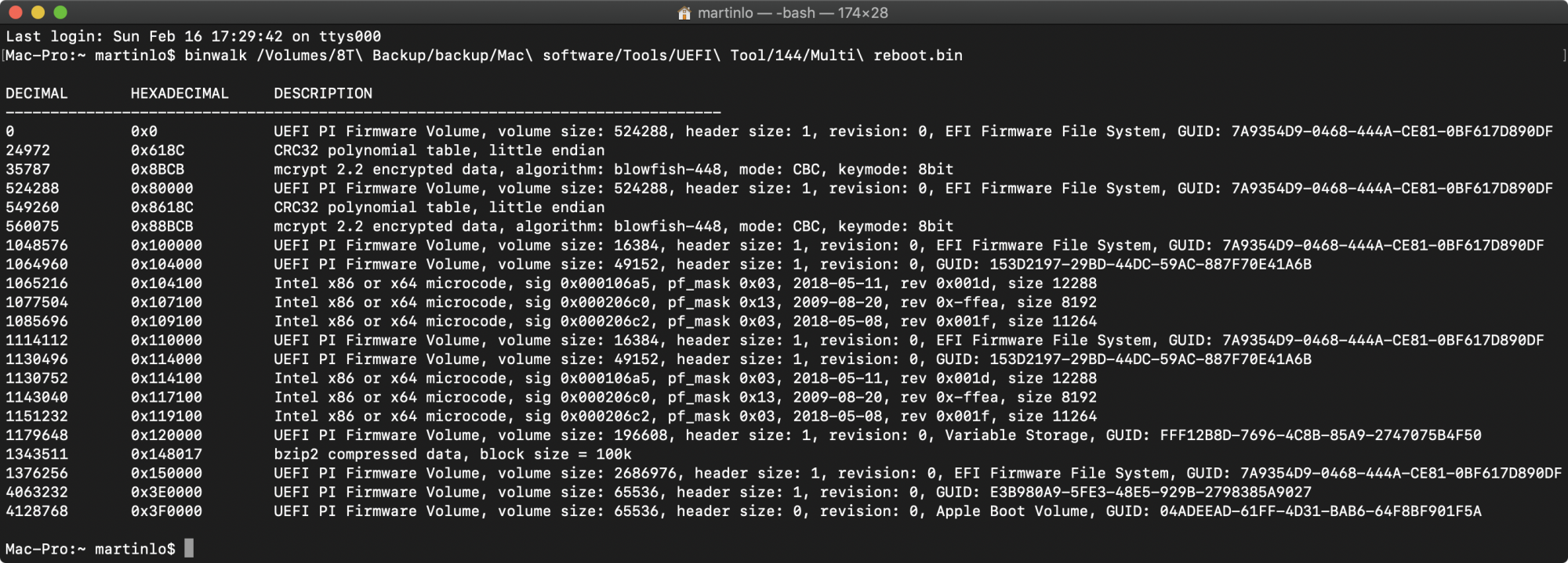

For those who don't want to install Brew / Binwalk, or not that familiar with terminal. You may also check the ROM image as simple as by using TextEdit (macOS build in apps). For corrupted NVRAM, if you search "Secure" (case sensitive) in TextEdit, you will see the actual certificate.
e.g. This is the Binwalk result from my corrupted 0087.B00 ROM image.

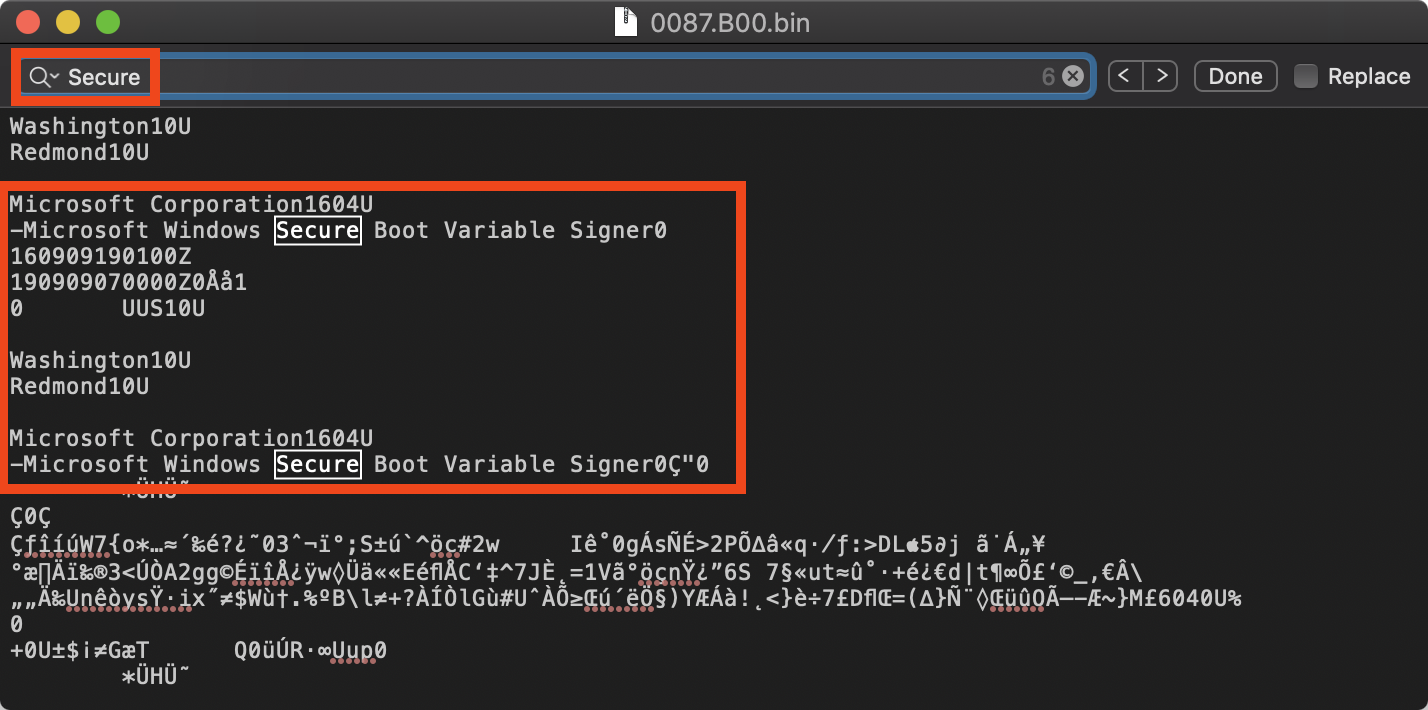

You will also see these two MS certs in TextEdit if you search "Secure".

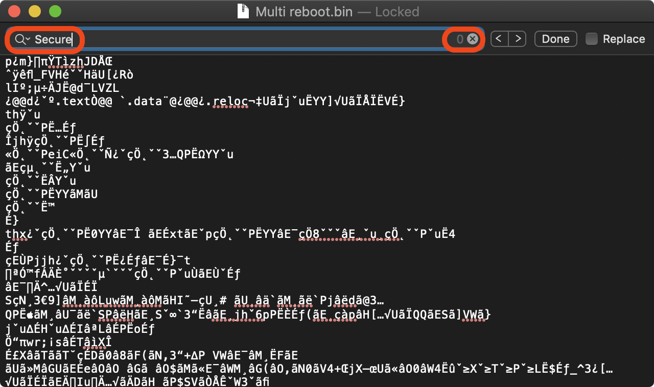

For a "healthy" BootROM, there will be no result
