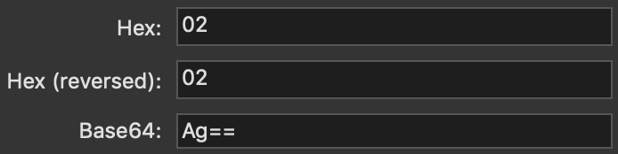

Normally UIscale in the Nvram takes care of this.
That's what I was thinking. It did fix the DPI so it's much clearer but it's not shrinking down the image. Right now I have is set to 4K I believe,
<key>UIScale</key>
<data>
Ag==
</data>
This look right? Got this from another response from h9826790 I believe.

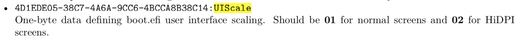

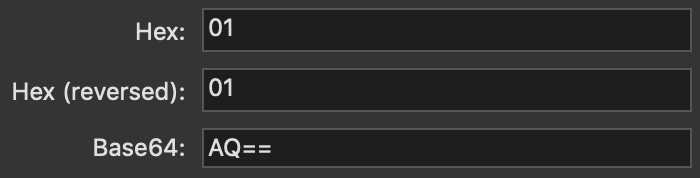

<key>UIScale</key>
<data>
Ag==
</data>
Change that to AQ== if you want normal 1:1 display (non HiDPI, or non Retina, or 1x scale)
