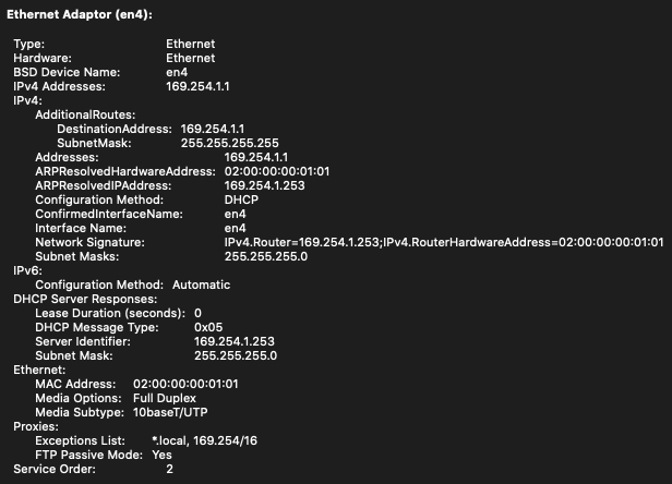

After updating to OC 0.5.7 I noticed I have a phantom ethernet adapter appearing in system preferences. If I remove it and reboot it comes back. Any ideas what this could be?
