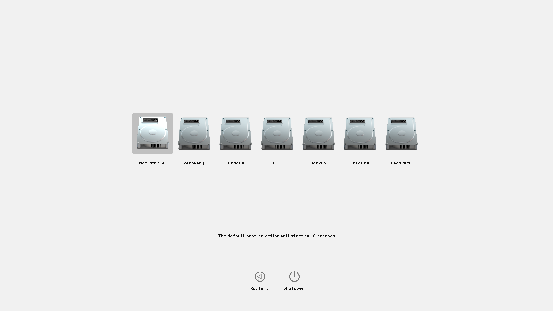

I just did a quick test with NdkBootPicker. I simply copy the icons form here to make the icon in my previous post.
Rename the png file to the icns required, then I can get this in NdkBootPicker

I haven't really explorer OpenCanopy yet. Not sure if its icns is the same format as the latest NdkBootPicker use. For NdkBootPicker, it's extremely easy, you can make any icon you want in 256x256 size, output that to png, then rename the file to the associated icns.
Thank you for sharing the NdkBootPicker.

Thanks for sharing the NdkBootPicker. Looks great and works well. For those who would like iconic images of their Mac OS as their icons I have attached a zip file of icons for High Sierra, Mojave and Catalina and a dark version of the pointer to drop into the Ndk Icons folder. The dark version of the pointer shows up well on a light background. Just rename your old pointer.png to pointer_light.png and place pointer.png in the Ndk Icons folder too.
Great job!
Now if someone converted the typeface that is used on the genuine Apple boot screen under the icons into the .png form as OC uses it, that would be just perfect.
