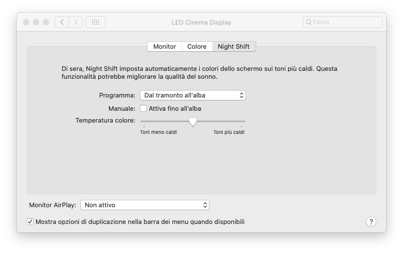

Hello
First of all I want to thank all of you for making it possible to start MacPro with OpenCore which for me, is much better than the Catalina Patch.
I ask if any of one managed to activate Night Shift for the monitor as it. The changes to CoreBrightness.framework with Catalina are practically impossible because after change I can not make cteminal command "sudo codesign -f -s - /S*/L*/PrivateFrameworks/CoreBrightness.framework/Versions/Current/CoreBrightness" for re-sign file,
Please help me... Thank you very much

This is what you want:
Reactions: TECK
Well, the plugin works fine. Did you try that?
Do you know where we can get the Night Shift enabler plugin? Install instructions is possible, thanks!
Edit: man you are fast. 😀
Looks like I have to install Lilu after all.
@cdf is this the only change I need to make into config.plist?
Code:
Note that the guide is being updated and will touch on installing kexts like NightShiftEnabler. Regarding your configuration: The name of the plugin is NightShiftEnabler (it is the current successor to the previous "unlocker" plugin). By default, the plugin ignores macOS versions without Night Shift, so no need to specify MinKernel. Also, try replacing <string/> by <string></string> (Xcode should do the replacement automatically).

In the link https://github.com/cdf/NightShiftEnabler I can download the NightShiftUnlocker.kext file that does not work.
The NightShiftEnabler is to be compiler but I can not make it
Reactions: octoviaa and cdf
It works
Thank you so much
