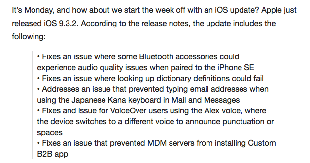

The 9.3.2 update made the audio on bluetooth Plantronics Voyager Edge unusable on iPhone SE. On iOS 9.3.1 with distorted audio was at least usable. 9.3.2 made it worse!!!

Update: Apple has released iOS 9.3.2 with a fix for iPhone SE Bluetooth issues.
