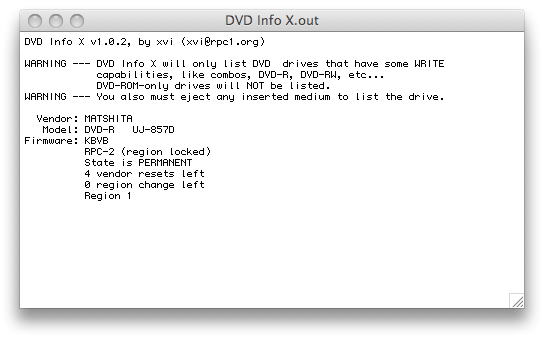

I'm having some difficulty flashing my dvd firmware.
I have followed the steps as outlined except when I run DVD InfoX I get the following screen:
and then when I run the region free firmware app, nothing hapens.
Am I out of luck because my state is now permanent. (I initially had one change left and used it trying to get the State to show as SET)
Any help would be appreciated.

State Permanent
Hi,
DVD Info X shows the following for my drive:
Vendor: MATSHITA
Model: DVD-R UJ-857
Firmware: HAEA
RPC-2 (region locked)
State is PERMANENT
4 vendor resets left
0 region change left
Region 4
Will i still be able to flush? I am using Tiger

when i run DVD infoX state is PERMANENT
cant i flash my firmware???
i'm using tiger by the way

Drive won't flash
When I run Info x. This is what I get.
DVD Info X v1.0.2, by xvi (xvi@rpc1.org)
WARNING --- DVD Info X will only list DVD drives that have some WRITE
capabilities, like combos, DVD-R, DVD-RW, etc...
DVD-ROM-only drives will NOT be listed.
WARNING --- You also must eject any inserted medium to list the drive.
Vendor: MATSHITA
Model: DVD-R UJ-857
Firmware: HAEA
State is PERMANENT
Region 1
When I try to flash the drive using the two apps ( the region free and the standard app) nothing happens. I tried installing them in reverse order but same results.
I would be really grateful for any advice you may have.
