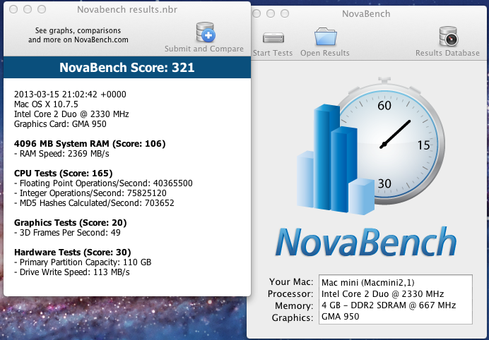

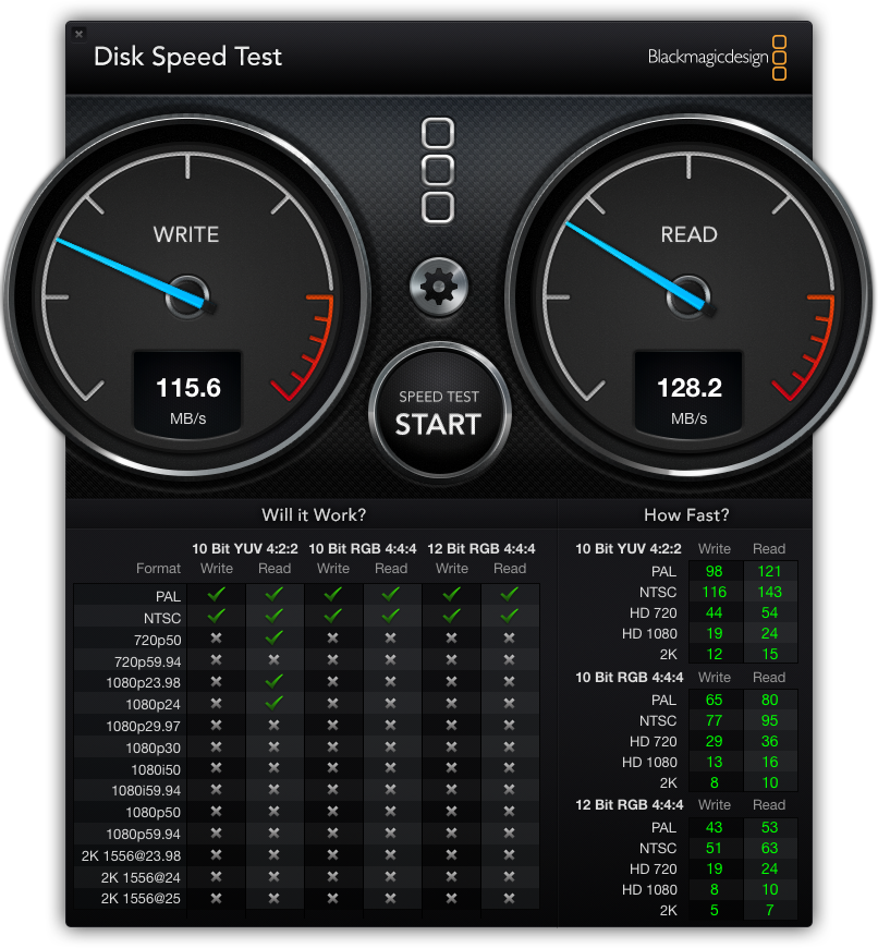

Benchmarks for this set-up are below. Note that the HDD is limited to 1.5 Gbit/s by the mac mini, the chip-set is apparently capable of 3.0 Gbit/s but I have not found a way to unlock this. Also to note is that initially I upgraded to OSX 10.6 and under this the HDD had read speeds 10mbps faster, so looks like OSX 10.7 may be slowing it down a little.

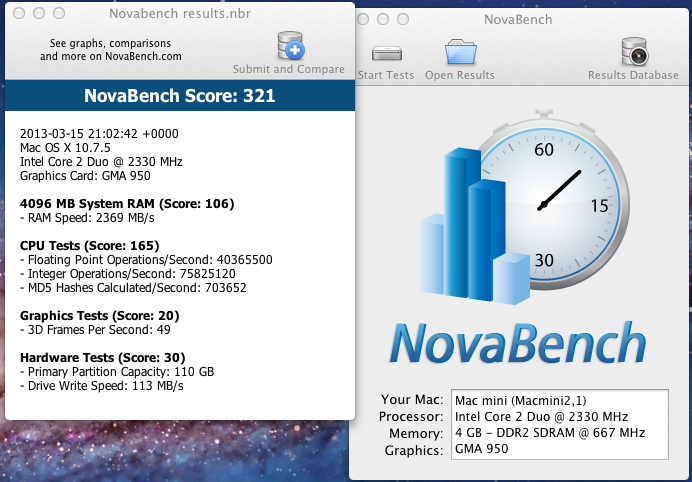

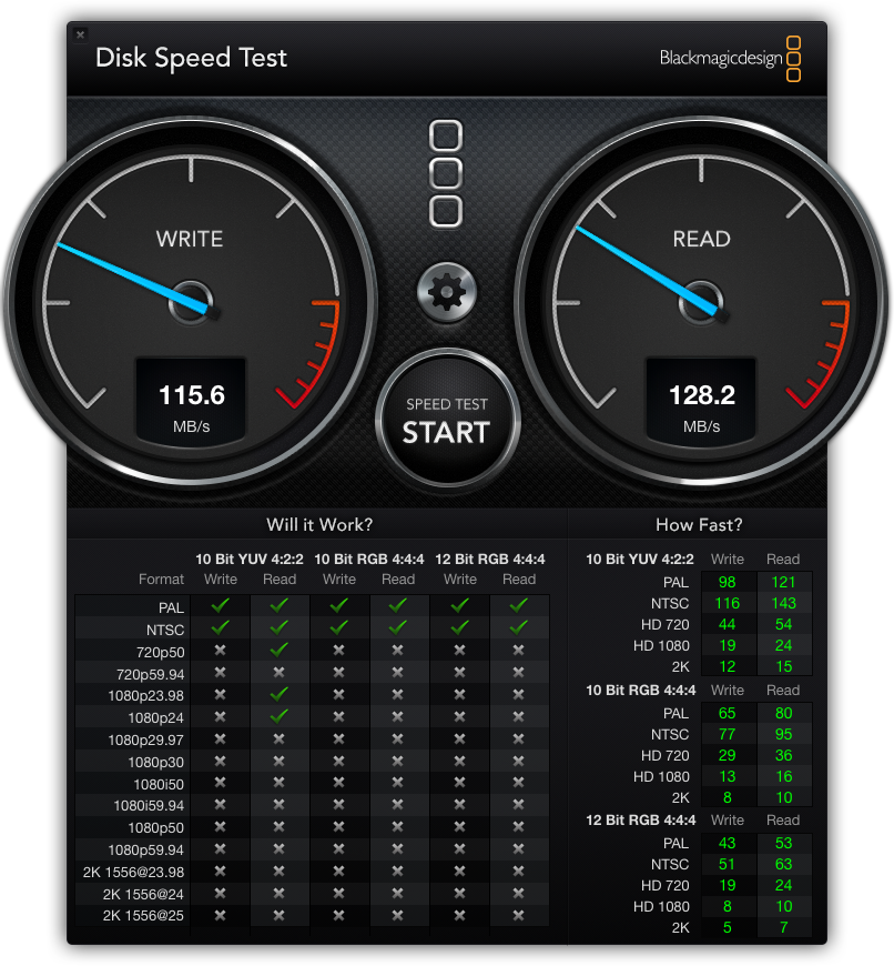

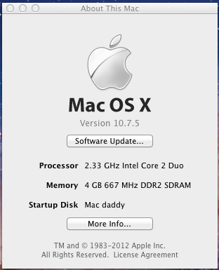

Benchmark results (under 10.7):
attachment.php
attachment.php
attachment.php
attachment.php

Any comments or opinions?
I would be interested to see results from other mini's that have been upgraded 🙂
well it is old gear and this has been done on this site years ago at a much higher cost. I do have 1 suggestion try a different ssd.
That chipset does not like ocz gear.
if you could find a samsung 470/810 ssd if may run at sata speed.
the 256gb size. I have gotten them to run at sata II in the newer 2007 1.83 and 2009 2.0 ,2.26, 2.53 ,2.66 models.
ocz ssd's often will not run at sata II in the older minis

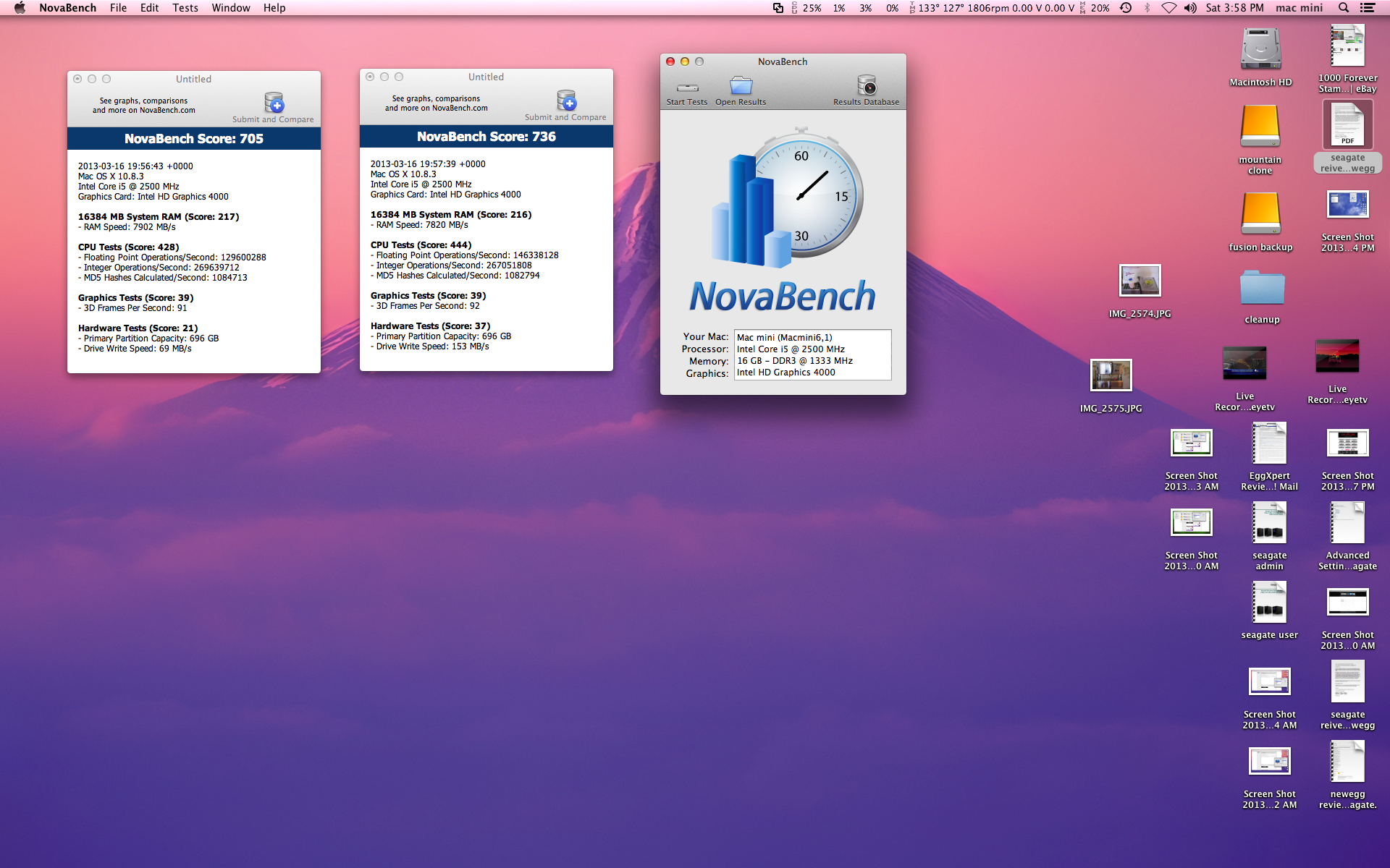

oh Thanks for the novabench results I just downloaded it here are scores for my 2012 mac base i5

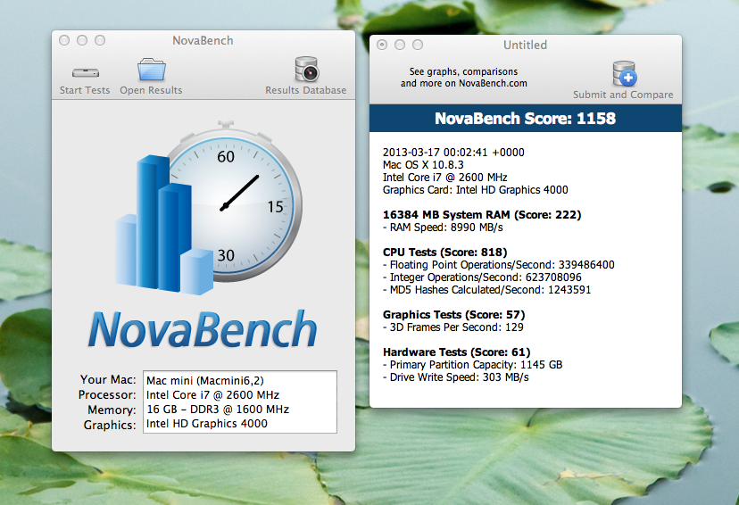

For comparison, here are the results for the latest top spec MM maxed out to my liking (budget):
2012 MM i7 Quad Core 2.6ghz
Fusion Drive with an OCZ Agility 3 SSD 240GB and the OEM Apple Hitachi 1TB
16G Corsair Vengeance 1600Mhz Ram
My SSD has never been super fast but it works ok for me.

I think geekbench is used more commonly on this site for such comparisons. How much of that ram is being actually utilized? Did you flash your 1,1 into a 2,1?
And it looks like your SSD is running at SATA I, SATA II ought to possible.
