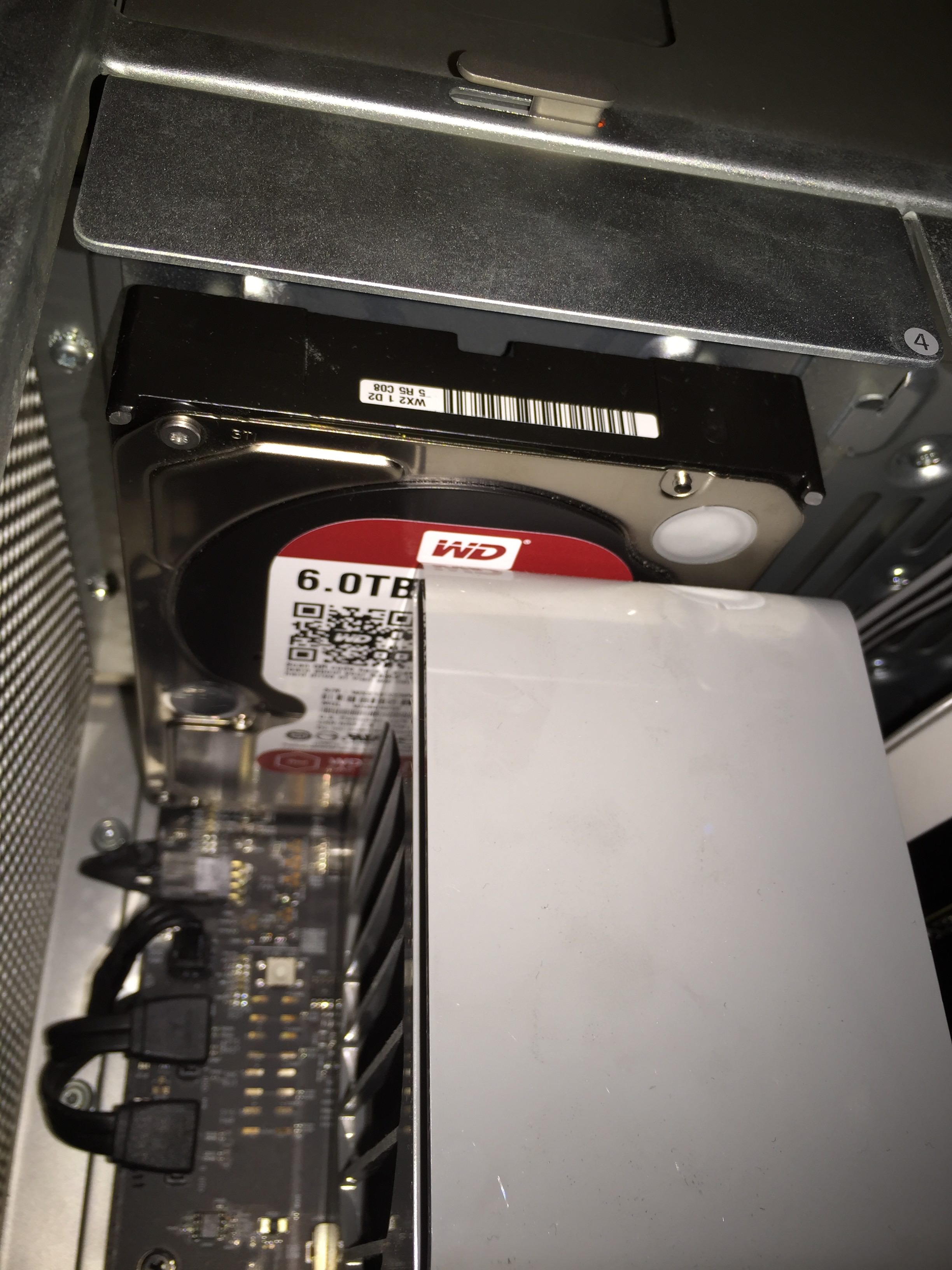

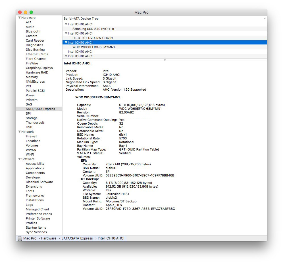

I am quite sure the 8TB work (or even 10TB will also work), anyway, my 6TB work fine. For large capacity HDD, be careful some of them not with the "standard" mount point. I don't know which one fit the cMP, all I can guarantee is that the WD Red 6TB works flawlessly on 5,1.

My 6TB WD Red just boot fine. It's my backup boot drive.

Just got a 8TB WD Red yesterday. It works, but also with the new mount point. It's actually OK to only mount the 2 screws that fit the HDD tray, remove the remaining 2 screws, put that HDD in bay 1, and use a little bit soft material (e.g. the anti static bag come with the HDD) to support it. In fact, this extra support is actually not required, the HDD can lie on the PCIe fan without any problem. However, by considering both the PCIe fan and the HDD do vibrate, so I just put some soft material between them to give the HDD some extra support and mainly for vibration absorption.
