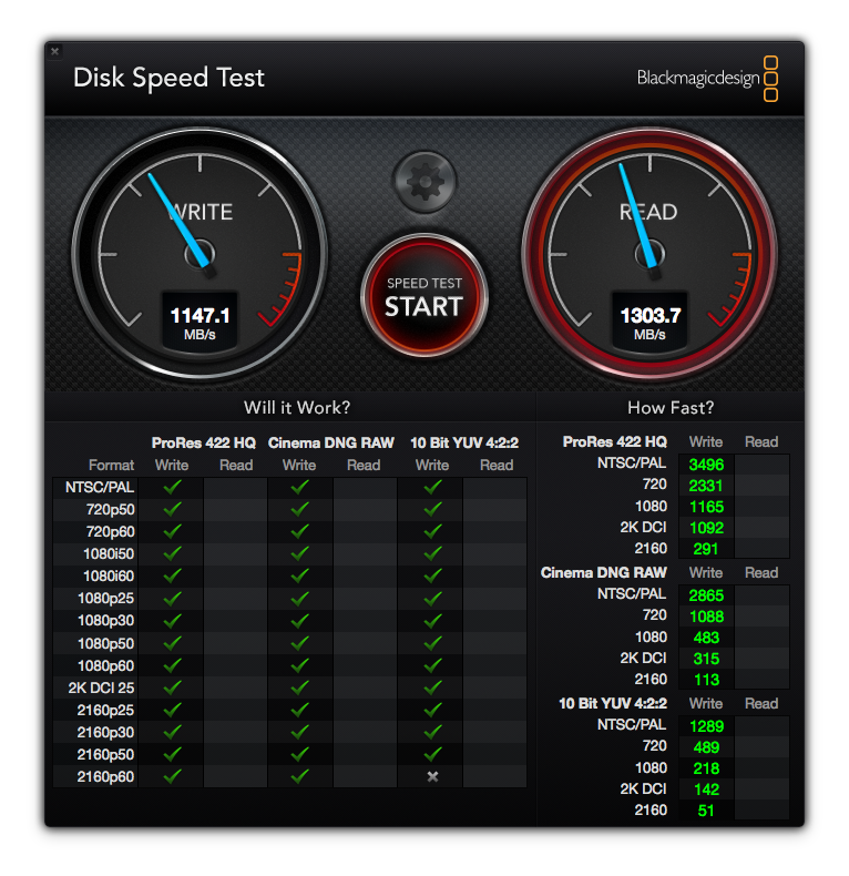

I don't know about sanity, but I just ordered another of these 480GB HyperX Predators (~300€). First one has been working great in a Mac Pro 4.1. 3D files and 3D libraries load fast, and big point clouds too. Hotlinks and modules update at speeds not comparable to SATA2 speeds earlier.
I appreciate the speed. I don't care about boot times, because I do not boot my machines very often. Actually I don't ever shut them down without a reason. They sleep.
This new card will go to my upgraded HP Z400 though. It's got only SATA 2 speeds originally. I need some more storage speed there for the same reasons as in my Mac Pro, 3D stuff, for both big files updated regularly (sizes of upto gigabytes) and for large collections of little files (libraries).
edit. continuous speed is good (attached), but I believe it's the fast acces times, low latencies and high IOPS that makes this and of course all SSD's so usable.
