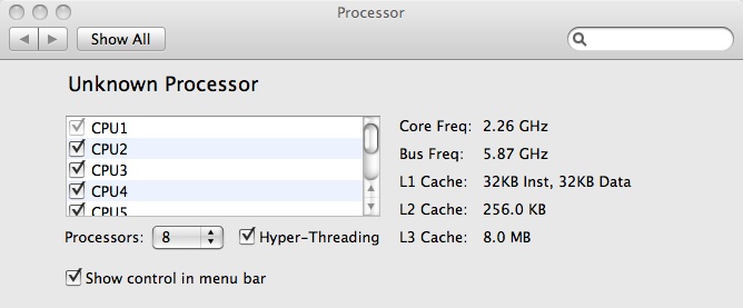

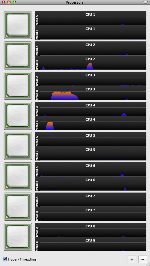

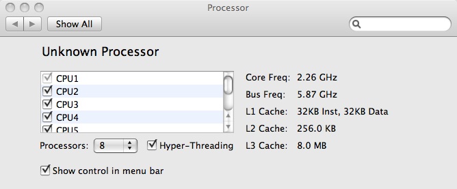

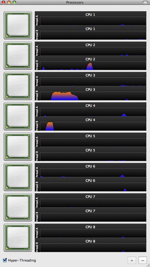

unfortunately the CPU preference panel doesn't seem to work quite right with the new CPU's. For a start, it says it is an 'unknown processor' and then when clicking the hyperthreading box, it just switches it to 4 cpu mode rather than actually turning of hyperthreading. Shame.
What is very clear from watching this panel while rendering, is that often 2 threads of the 8 will be running on the same core, which is not a great use of resources

ok, to give an idea about what kind of effect this problem is having:
When setting the CPU's to turn off hyperthreading, it actually just switches to 4 cores... there isn't a combination where it will let you have 8 cores and no hyperthreading. In this 4 core scenario, a render took 1:07.
With 8 cores (and hyperthreading having to be on) it took 0:56. During this test there were 3 cores running 2 threads each, and a further 2 cores running only 1. This varies from one time to the next. It would be reasonable to expect that if the 6 threads that were sharing 3 cores were actually distributed across 6 physical cores that the performance would increase by a further 20-30 seconds or so given the 10sec improvement when 2 threads have their own core.
Apple must make a way for us to turn off hyperthreading, or Autodesk should just make sure that mental ray for maya understands the difference between cores and threads

I'm not sure you understood my previous post. The result with all 8 cores turned on had 6 threads running on 3 cores, so only 2 threads benefitted from all 8 cores being turned on
edit - so basically, OS X (or maya?!) isn't very clever about distributing the workload with hyperthreading turned on

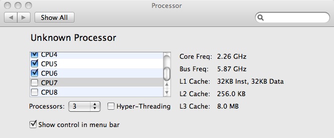

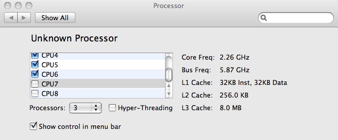

just to confirm that the processor pref panel doesn't really know what it's doing with these chips see the below pic. Also, if you un-tick the hyperthreading box on that window, you are left with 8 cores visible on the list (same as with hyperthreading enabled), but the drop down changes to 4 CPU's and if you untick the CPU's in the list, when you turn off 7&8, the drop down list changes to saying 3 CPU's

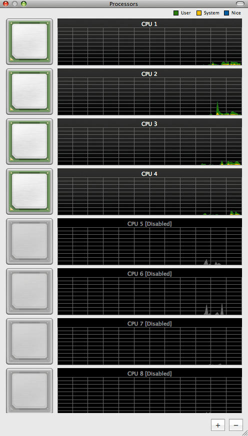

to illustrate what I was saying above, see the image below. What this seems to indicate with the CPU list is that it is actually 4 cores with hyperthreading turned on despite having turned it off.

No, this really looks to me like the checkboxes are correct, and what is shown in the graphic is that the first 4 CPUs are actually all 8, and the last 4 are the extra "hyperthreading" threads. Where it says CPU 1 Thread A and Thread B, I think that is actually core 1 and 2.
Your own comments support that. You said when you disable hyper, you see CPUs 1,2,3 and 4. When you go to the checkboxes and disable the last 2 (7 & 8) CPU #4 disappears from the graph. That would support that all the hyper threads were already disabled, and you just turned off 2 cores which where being represented by CPU 4 Thread A and B.
It may be either the way it was programed for all processors before hyperthreading, or a error made. Try having hyperthreading on, and disable ONLY CPU 2. In the graph what happens? I would guess CPU 1 Thread B, and CPU 5 Thread B will stop.
Also when you say when running Maya it shows 3 CPUs with 2 threads and 2 with 1. Well if the above is true, then it means CPUs 3 to 8 have 1 thread, and CPU 1 and 2 have a second thread running. That makes absolute perfect sense.
