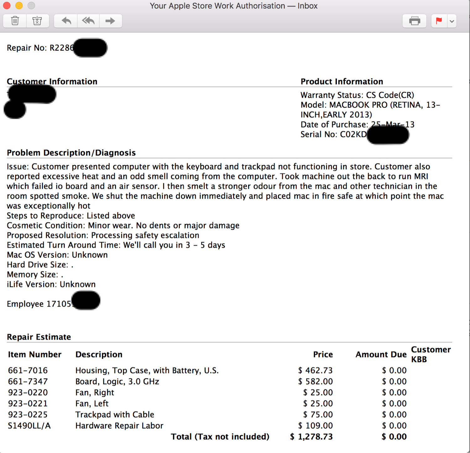

Anyway, if the attachment works, you can see what they have said about it. (Screen shot of the work summary they provided me).

Keyboard and trackpad not working and the odor are indicators to me that the battery was swelling and had subsequently burst (or at least vented) when you presented it for service. It escalated quickly from there and ended up catching fire - which is a distinctly possible result with a swelling battery.
I don't deal with NEARLY as many Macs as my team deals with Dell, Lenovo and HP products. I've heard of several "fire" reports from others on the other manufacturers but I have yet to deal with a similar situation with a Mac. I DID have a Mac with a swelling battery, it was out of warranty so I pulled the battery and transported it to the local Apple store for disposal.
