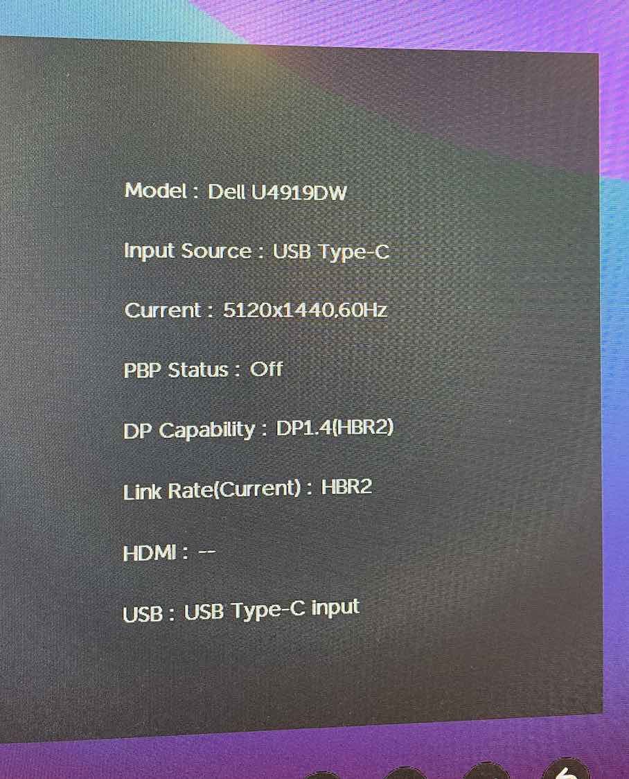

Weird. With my Philips 499P9, I only had 30 Hz at first and needed to change one USB setting from 3.0 to 2.0 to get it up to 60. Other than that, it worked just fine from the start without any visible or audible impact on the system.

It was plug and play. I used the USB-C cable that came with my Dell monitor. I just plugged the cable into the monitor and into my Macbook Air M1, the monitor asked if I wanted to switch to the USB-C input, and I was done. I didn't change the resolution or the refresh rate. I didn't install anything on my Mac nor does Dell have any software for the Mac.
