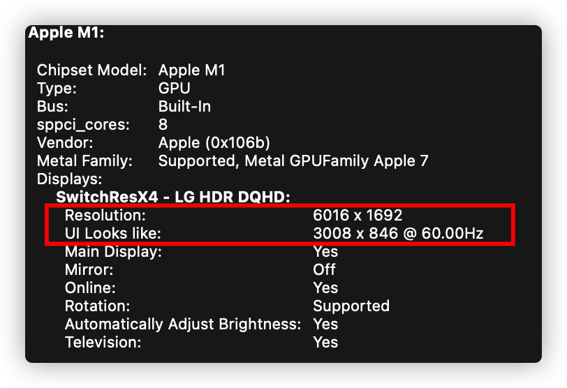

Here is the reason I chose to have 3008x846@60, it is HIDPI, the resolution is actually 6016x1692.
My surface book 3 can do 5120x1440 with 150% zoom perfectly, but it still looks slight worse than M1 with 3008x846@60,

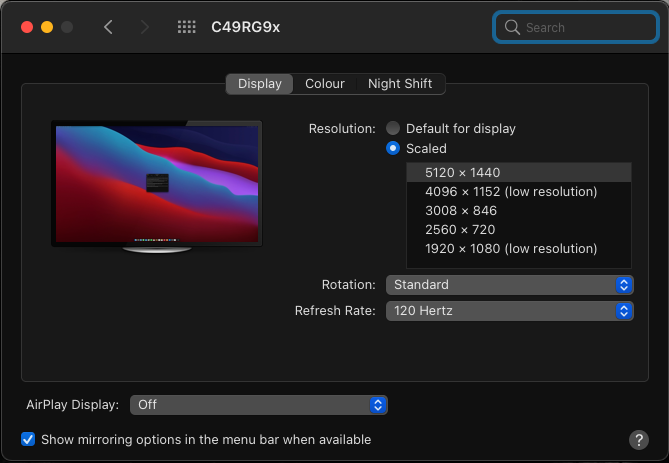

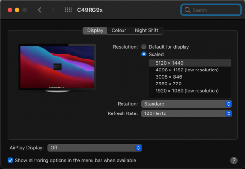

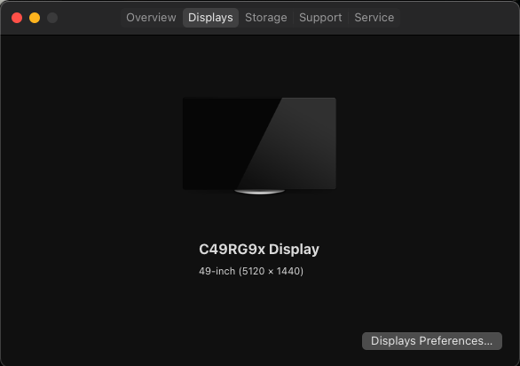

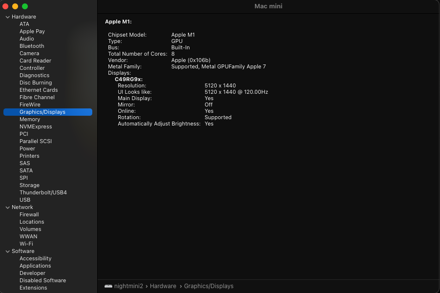

Just got my Samsung C49, hooked it up via TB3->DP Adapter + DP cable (all rated for 8K60Hz) - booted up into macOS - was automatically set to 5120x1440 - only had to switch from 60 to 120Hz in the dropdown menu, didn't do anything else.
After first shutdown behaved a bit flaky, but after setting the DP-Version "down" to 1.2 everything worked nicely (even though 5120x1440@120HZ is supposed to need about 26Gbit and DP 1.2 only delivers about 17Gbit it's working without hiccups...
When set to 60Hz I can also choose HDR in Display settings
