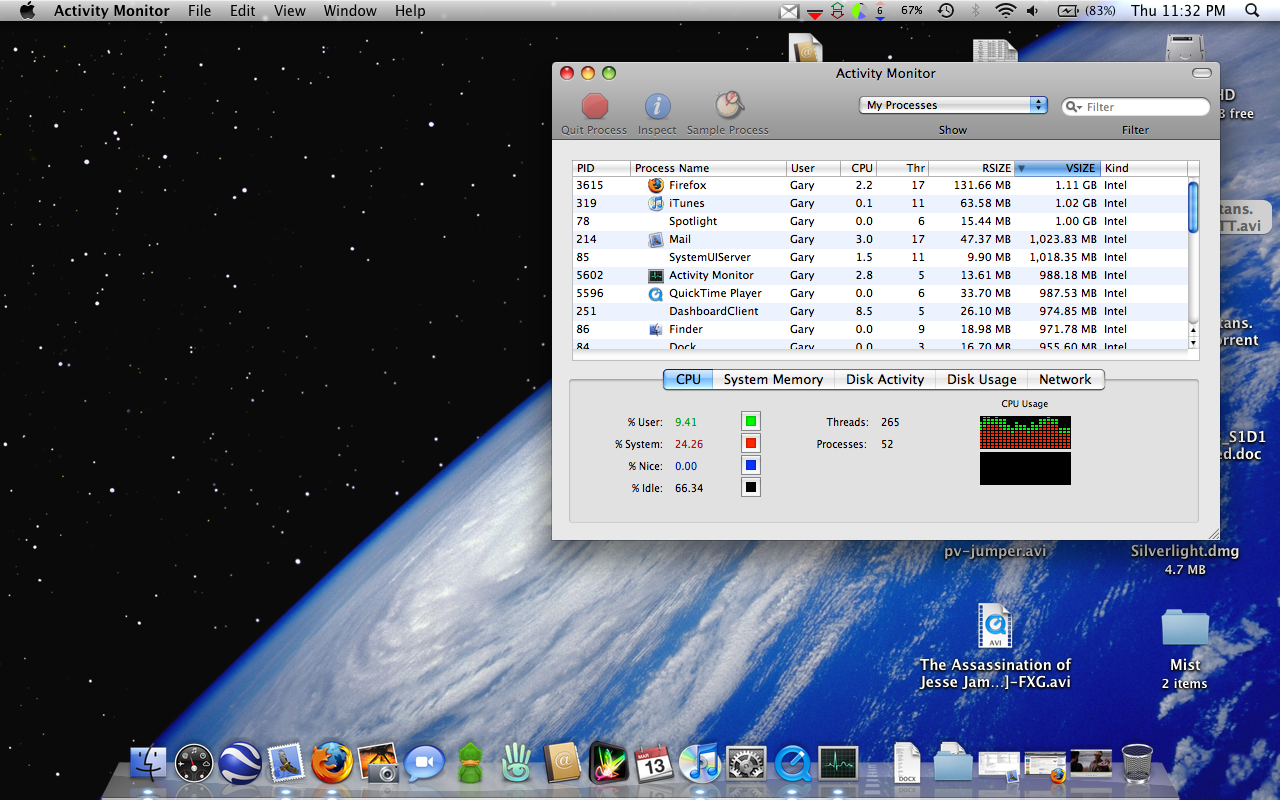

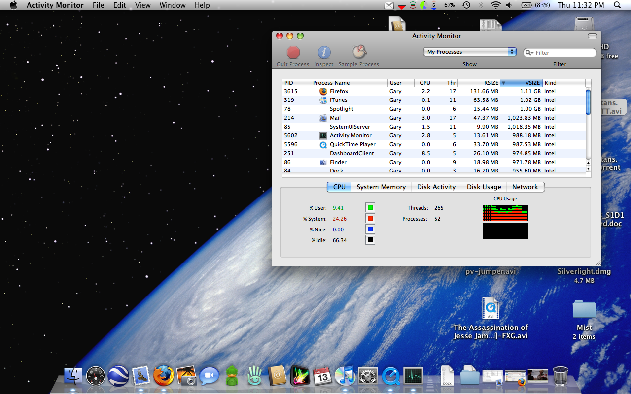

Core shutting down for no reason
I doubt it, you have 'My Processes' selected at the top on Activity Monitor, if you change that to 'All Processes' you should see the process (obviously a system one.. not one of yours..) that has crashed and be able to kill it, you will also get some idea of where to look to start fixing it.
Nope... What happens is that the CPU overheats and one core shuts down for 10 seconds or so then starts back up. I had this happen to me. It was not a system issue.
I cloned my old MBA (week 2) hard drive to my new MBA (week 11) and I have no problems. This rules out a software issue.
Ah, i was so busy looking at how overloaded that one core was i didn't see the fact that the other one wasn't doing anything at all! my bad.
No saying this isn't authentic but something is odd. The numbers say over 66% idle, yet the picture shows one core almost maxed.
