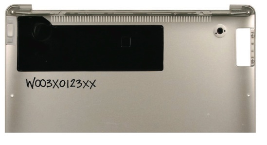

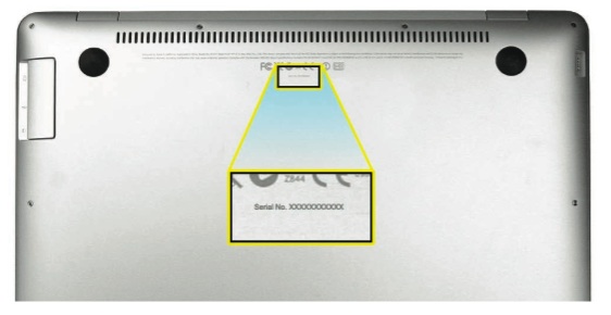

other than the serial number on the back of the MBA, is there another physical location inside the MBA I can find to prove its specs?
I purchased a used MBA and the SSD is wiped clean and the serial number on the back is not visible. Seller claimed 2.13 SSD, but I have no way to find out. Any suggestion??
SSD is wiped clean. Window 7 is installed. So no trace of serial electronically--Not that I know of. I'm hoping Apple "hides" a set of physical serial INSIDE the MBA. Any other suggestions?
So the etching on the bottom case of the MBA has been scratched away?
If so, the only other method is the previously posted method using OS-X.
On the off chance the bottom case had been replaced [by Apple], the original serial number should have been written on the inside (you'd have to remove the bottom case to check). There's no other physical labeling that I'm aware of.
+1 If OS X isn't installed either that would set alarm bells ringing. Why would someone sell a Mac without OS X installed?
I would not consider it to be alarming for someone to sell an MBA without OSX installed. When I got my MBA, my full intention was to wipe OSX and intall Win7 and not have OSX at all. BUt once I played with OSX, I decided to keep it. The serial number being removed is much more alarming.
Is there no software that can be installed in windows that will read the SN? Maybe a diagnostic type software?

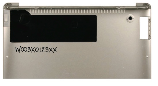

Here are the two places it should be. The 2nd one is only if its been services and they wrote the SN on the back.
