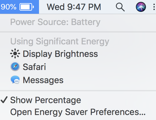

Brightness weighs very heavily on all MBPs 2016 and up because of the incredibly bright 500 nit display. Keeping your brightness down will have a huge positive impact on your battery. You can even see if you click on the battery icon in the menu bar, it'll tell you the display is using significant battery power.
