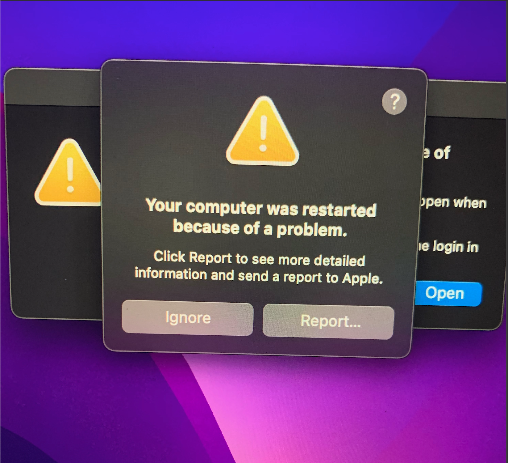

I recently replaced the OEM SSD on my 2015 MBP 13" with an OEM SSD from a 2015 15" (preformatted with Monterey). After switching to the new SSD, I did an internet recovery and formatted the SSD afresh then restored data from a previous backup of the 13" made in macOS Catalina. Ever since then the machine keeps reporting a "reboot because of a problem."
I have narrowed down to this reboot only happens when the machine sleeps from closing the lid but when manually selecting sleep from the Apple Logo menu, this doesn't happen. Here is the crash REPORT.

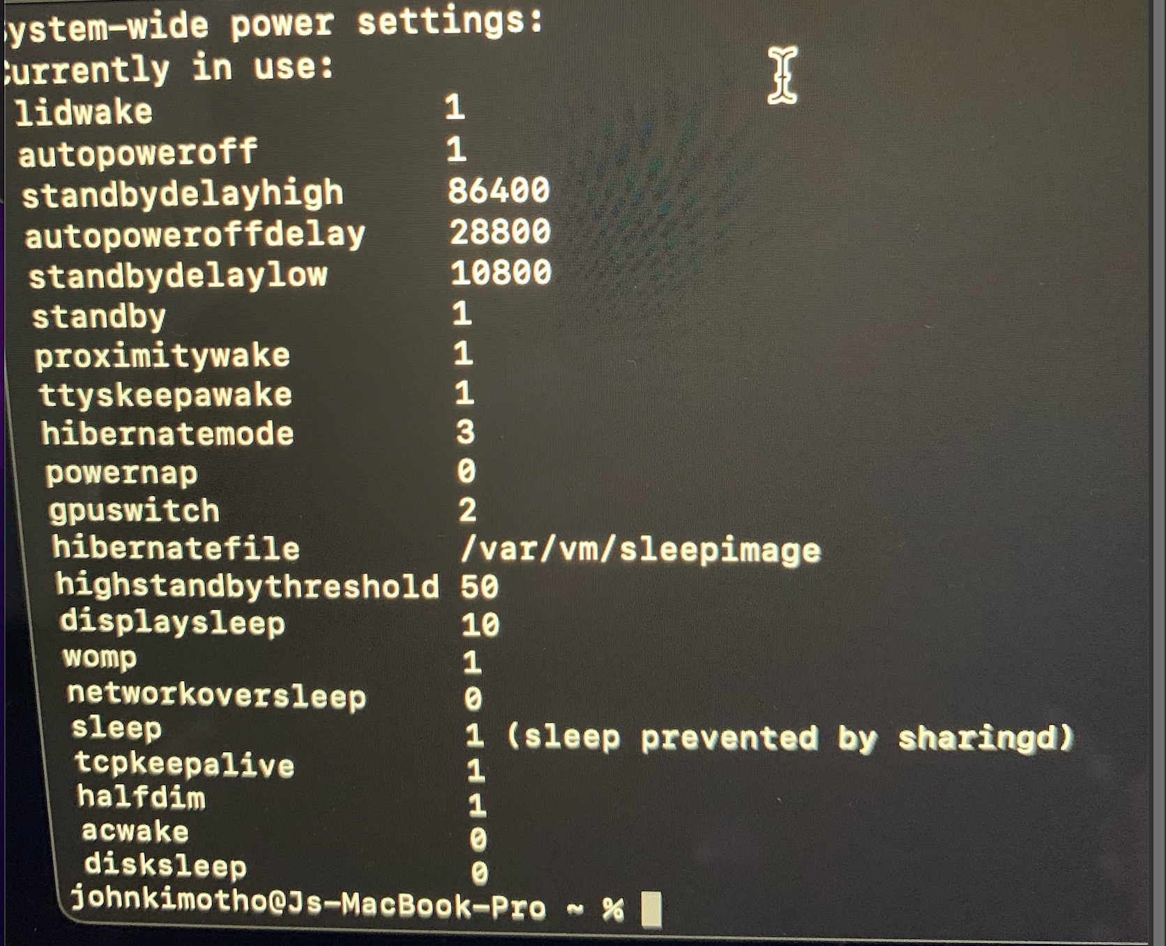

The SSD never used to do this when it was on the 2015 15." I'm at wits end trying to figure out what could be wrong. I ran a pmset -g and below is the result.
