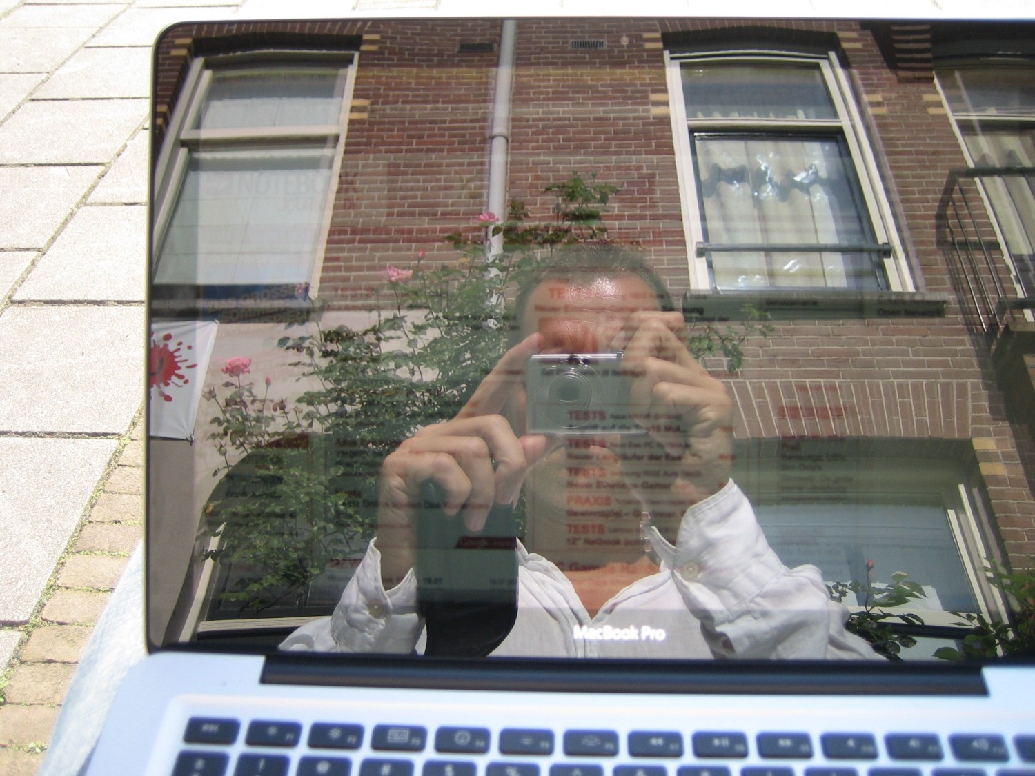

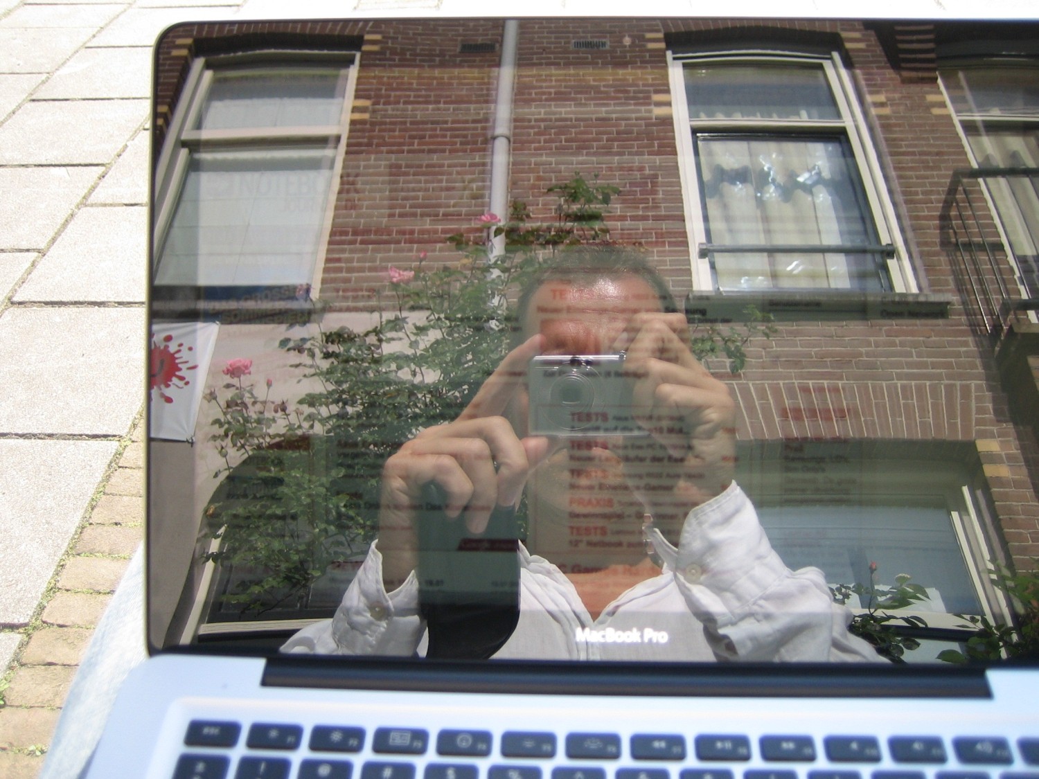

I agree bright enough for inside, not for outside with sunlight. Thanks for your profile, I'll try it.
