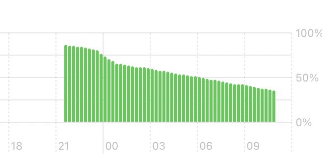

When it’s sleeping it loses 30% overnight. Same pmset log as you, along with outboxnotempty reason for waking.

Ok I did all the test, and it is an hardware problem. Or the mac is cursed.
I backed up everything with superduper AND time machine, then I wiped the hard-drive and performed a clean install of the OS.
After the clean install I started the mac, created a user but I did not enabled anything. I even didn't logged in my apple account. It was only a plain mac user with no custom apps installed. I closed the lid and unplugged the charger when the battery was 100%. After 3 hours it was 90%. No process running, nothing.
During the night I had another doubt, maybe it was a faulted OS version?
In my first attempt I restored my mac using the version that was already on my mac. So to be sure I downloaded the last MacOS version as a .dmg file and created a bootable hard disk. I wiped the hard disk again and performed a clean install from the bootable disk.
Created a new user (nothing except for the touch ID was turned on, I skipped every step in the setup so no screen time, no siri, no apple account....), closed the lid and go enjoy my life.
After 4 hours the battery had lost 12% of battery.
At this point, I don't know what to do anymore. Will report this data to Apple and hope for a replacement. I will bring the mac completely wiped to the apple store. I have approx 1 hours to the closest Apple Store. I will put it to sleep to 100% so I will be able to show from the battery stats that the battery continuously drop with no reason.

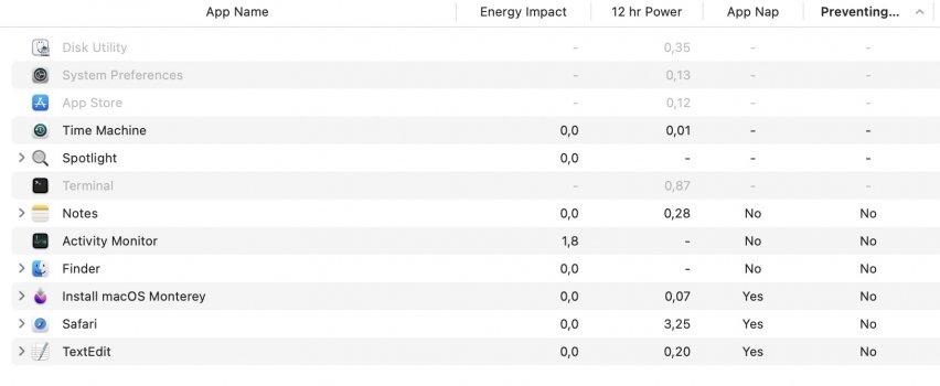

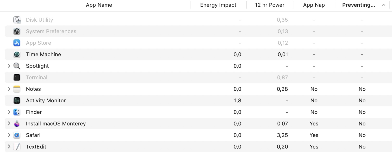

I attached some screenshot from this night when I put it to sleep with a empty user with no custom apps and Apple account logged in.

Finally I took it to the Apple store. They seemed a little confused to me.
We ran a basic diagnostic and it was all ok.
They started talking about software problem but I told them about my tries with clean install, not logged-in, of mac OS and they looked very very surprised.
I left to them to take a deeper look, they will let me know the next week. Hopefully we will have some answers.
AFTER 3 WEEKS THE APPLE STORE CALLED ME BACK WITH NEWS.
This problem is pesky, and it needed the escalation to the Apple Engineering Team that is very slow.
All the hardware is ok, the problem appears to be software, and related to the Bluetooth that basically does not sleep.
They told me the problem is solved with the update currently in beta (MacOS 12.3). I hope it is true. Is not very useful to have a 3k laptop that drains while should sleep!
