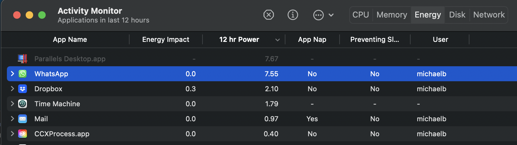

Does Activity Monitor > Energy tab > 12 hr Power give you any clues?
Don't know what the units are but it might help.

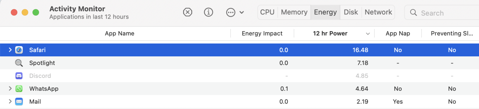

Safari seems to be highest on the list at the moment.
There doesn't seem to be and I haven't changed my browsing habit since this begin - some news sites and youtube throughout the day. I can't figure out why the drop off is occurring. Could it be the hotter weather? I know that can affect battery life... battery temp is currently 35.3c
