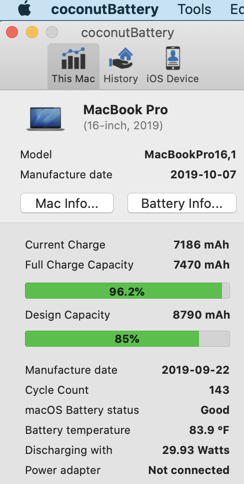

So I have my 16" MBP connected to a 27" TB LED display since day one and the battery health has dropped to 85%.
Should I be worried ?
It's been a year and I do have AppleCare+....
I do use the MBP with the 27" as a dual display (not clamshell) - and does run warm so I put a laptop cooler fan underneath the MBP since day 1 - not sure if that helps or not....
