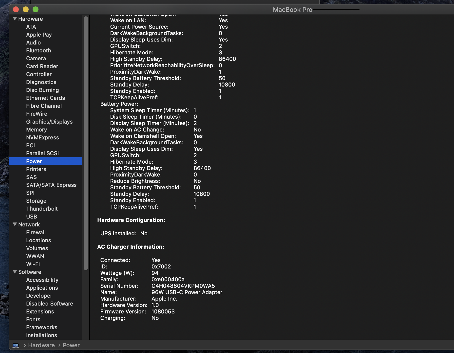

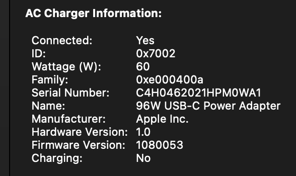

For those of you using a MacBook Pro 16" did you realise that the AC charger info states 60w even if you are using a 96w charger?
is this normal? if so then would a 60w/ 85w charger be enough?

Authentic Apple charger with MBP16,1 says 96W for name and 94W for wattage report. Anything less and you’re using a different charger or there is an issue.
To add to this, my authentic Apple charger reports firmware 1070051. All other info except serial the same. Still on Catalina, 10.15.7 (19H524).
