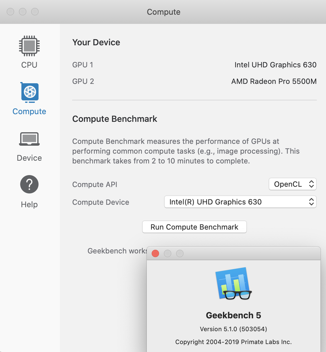

Did you guys do this test by the way, it needs to be done with 5.1.0 - it forces a display driver crash, and if the device reboots when the crash happens, it's considered as an internal graphics failure :/ (Maybe Metal needs to be used, I forgot, but the UHD 630 is the culprit)

Can you guys test the Internal GPU health test that people discovered with Geekbench 5.1.0? You might have defective hardware
He's saying that he's never sleeping his Macbook
Just finished the Geekbench test, verion 5.1.0, successful test without issue, the OpenCL Score is 5030
Great to hear 👍
If it didn't reboot, no obvious hardware issues
