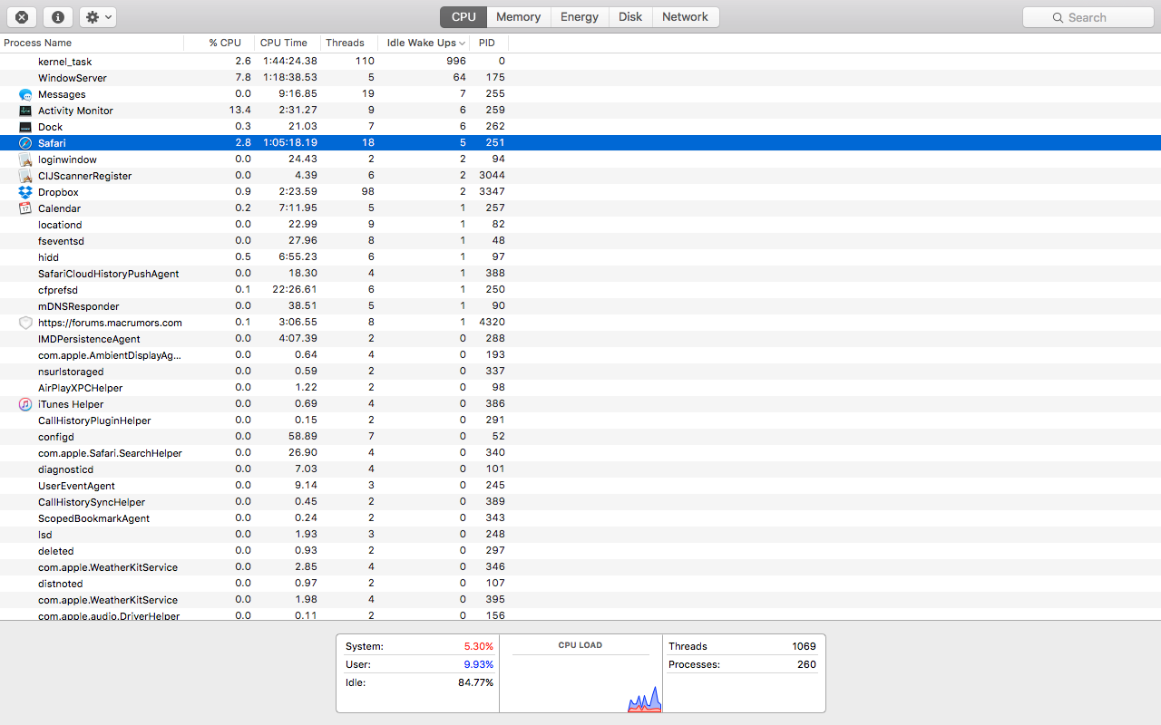

Not sure if this helps

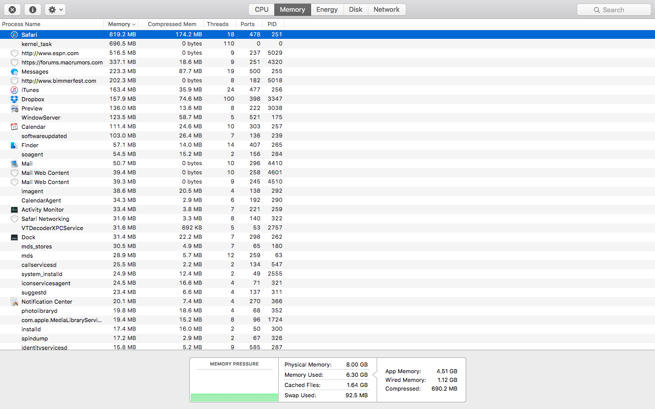

Memory doesn't appear to be a problem. What about cpu usage?

[doublepost=1503804125][/doublepost]Screen Shot 2017-08-26 at 11.21.23 PM.png
