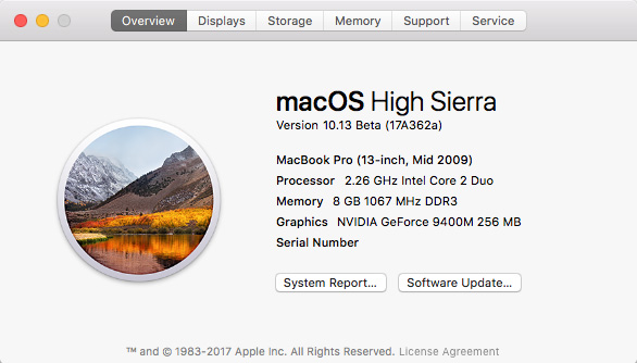

If you are going to upgrade the OS, don’t bother installing Sierra. Jump directly to High Sierra if the hardware works with the patched installer. I've said this in other threads but it bears repeating: If you have an SSD and 8 GB RAM, High Sierra runs decently well, and overall feels similar to El Capitan in terms of OS performance.
Furthermore, High Sierra brings compatibility with HEVC (realistically up to 1080p30 on these old machines, but not 4K), and HEIF from iOS 11 iDevices, with compatibility in the new updated Photos application. Also, High Sierra improves the surfing experience greatly in Safari, esp. because of the auto-play blocking feature. High Sierra is one of the bigger OS upgrades in a long time IMO.

Will this allow me to use 16gb of ram or is that hardware based?
