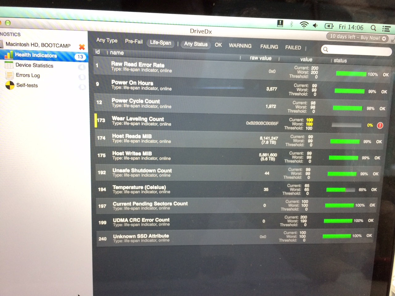

Hi all,
In the last few days my MBP has started reporting that the SSD is close to failing. Its late 2013 15inch model with an Apple 500GB SSD.
I searched these forums and ran DriveDX that reports the 'Wear Levelling Count' is at 0%, how bad actually is this!?
I use the laptop every day for work, primarily running bootcamp but i cant see that would make a difference.
The service hours are reported as 3577 hours, and the host reads/writes are 7.8TB and 5.6TB respectively. (see attached screenshot).
Is there a fix for this? Is the drive really about to fail with less than 2 years service?!
Any guidance would be appreciated.
Ben

I think it is just the program failing.
Check the speed of your SSD and it will give you an answer (program fail vs SSD fail).

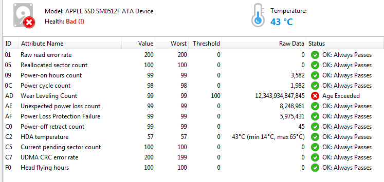

Hi there, thanks for the response. I ran the black magic speed test which indicated a read/write speeds of 731/631mb - are those acceptable speeds?
I also ran an Auslogic tool in windows and it also reported a wear level problem as shown below:
Its does all seem consistent but strange?!
Speeds are fine by me. Yeah it is strange. 😀
From another forum:
It's up to whatever app how they interpret the smart data
more often then not they just set standard alerts of like 10 for everything
My wear leveling count on my M4 is 49
the most important one is
Reallocated_Sector_Ct
and a few with "Fail" "Error" or "Uncorrect" in the names are likely worth watching
Based on that, your drive is good.

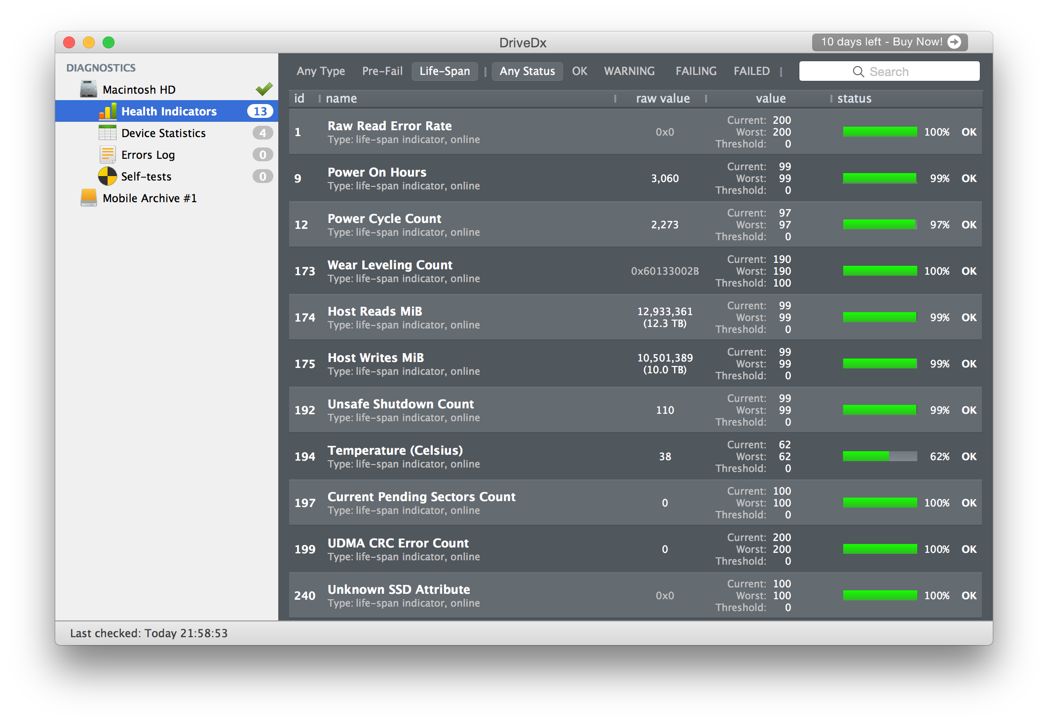

My 2014 13" rMBP 2.8Ghz, 512SSD has read over 12.3TB and written over 10TB and the wear levelling count is still 100%.

5.6 TB written on a new SSD is a joke. Your SSD should be good as new. There has been an extensive SSD test a few years ago where all SSD´s passed the 500.0 TB write mark, some made up to 1.0 Petabyte. This has been well beyond the specifications for some drives. The test lasted several months due to the huge data volumes needed.
Here is just another test I found. In this test the worst SSD started to reallocate sectors ( not failed ) at 300.0 GB, which is over 50 times more than your SSD has written so far.
http://techreport.com/review/26523/the-ssd-endurance-experiment-casualties-on-the-way-to-a-petabyte

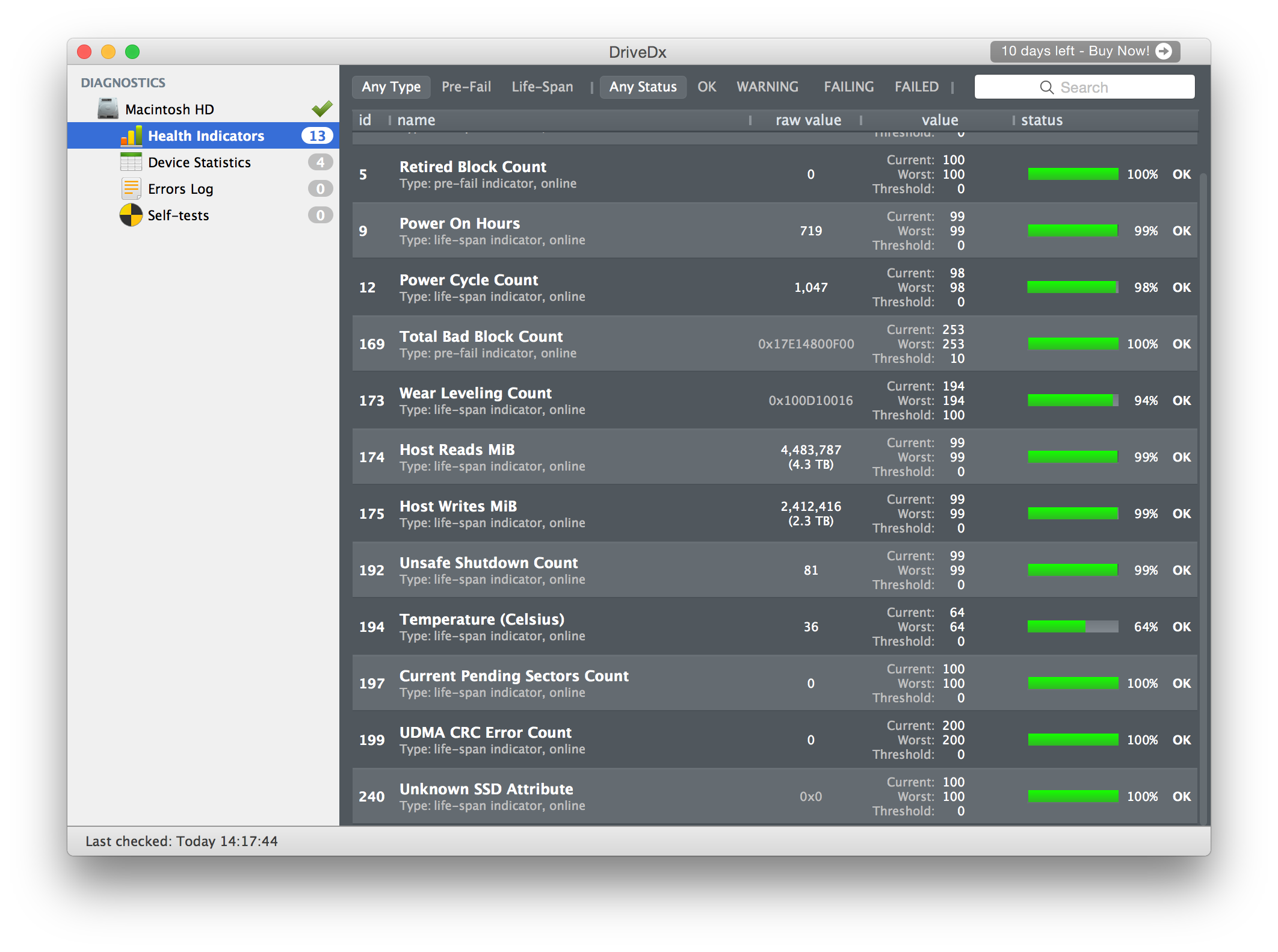

Sorry to hijack your thread, but my 4 month old rMBP 2014 15" has a wear levelling count down to 94%. Should I be worried?
Well at 1.5%/mth that gives you a life estimate of 5yrs. How much data does DriveDX say has been written to the SSD?
For comparison I've just moved my 512GB Crucial to another machine, it is 6mths old and has 97% remaining. The 1TB Crucial now in this machine is brand new, 100% remaining and has 0.5TB written to it...
To keep the SSD discussed, is risky IMO. Whatever the problem is, there is a problem. It is Samsung hardware, so Samsungs SSD life expectations may be appropriate. The drive has written less than 6 TB and is defect.
The SSD of user Aneef has written 2.3 TB and is at 94%. This seems not great to me as well but in an acceptable range. 512 GB Samsungs should be able to write 150.0 TB minimum, smaller drives less.
Hopefully those wear levels are not the price to pay for early PCIe M.2 4-lane SSD´s.
My 2 years old Corsair Force GT 480 GB SATA III has written 22.5 TB and is at over 90%. This translates to a 20 years lifespan before the Corsair's MLC NAND wears out ( assuming the high daily data volume remains constant ). I guess someting else on my SSD will break before.
