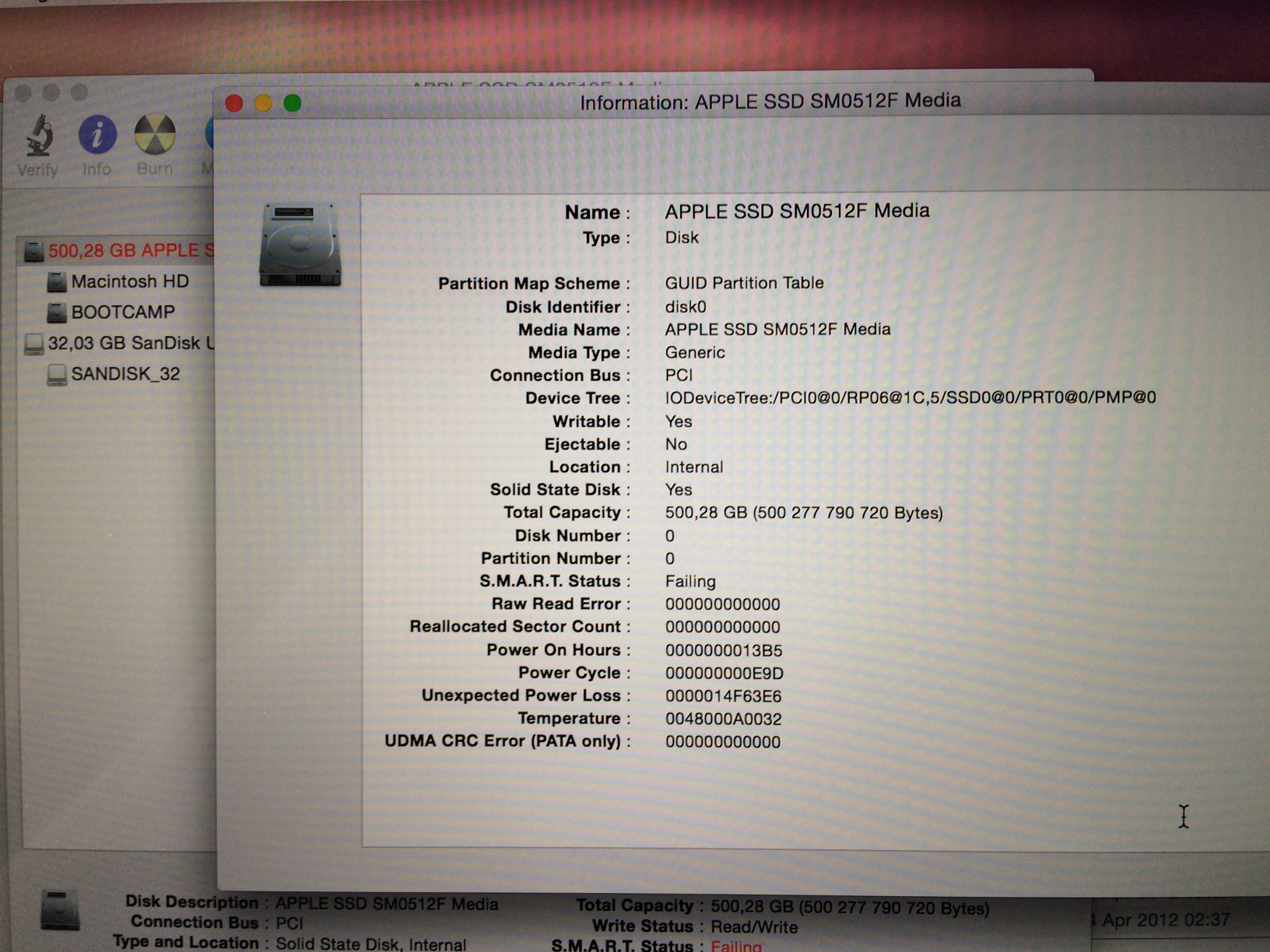

Same problem with apple ssd here. Macbook Pro Retina Late 2013 SSD reports problem after 2,5 years of normal use. Smart error - Wear Leveling Count - Drive failing. I am working mainly in bootcamp win7.
Wear Leveling Count isn't reported correctly, for some reason (or third-party apps aren't interpreting it correctly). The raw value translates to P/E cycles, so the SMART data suggests you have consumed billions of P/E cycles, which is simply impossible. I suggest you run Apple hardware test in case you want to make sure everything is good.

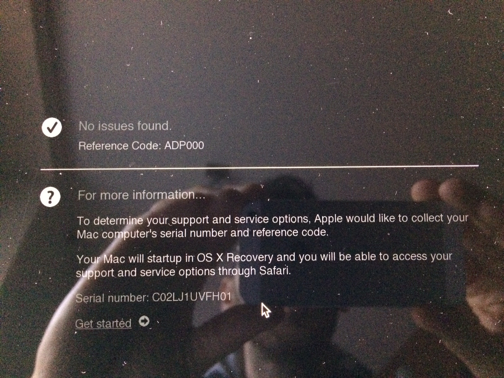

Thank You for reply. Ok, so i made a test with apple diagnostics. No issues found. (see photo)
BUT, in Mac os (same in bootcamp win7) is still SMART error found. (see photo)
When I try to install Mac OSX ElCaptain, it tells me that I can't install becouse of SMART errors on the ssd disk.

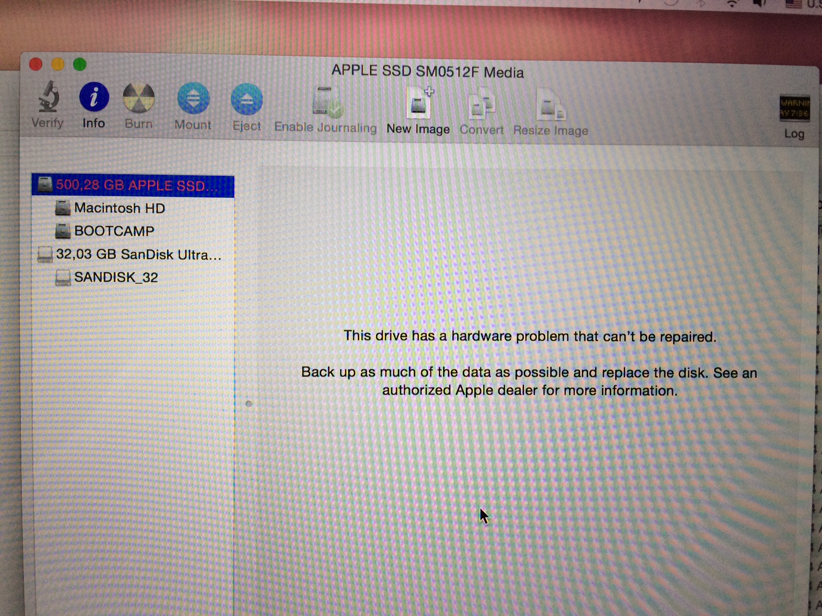

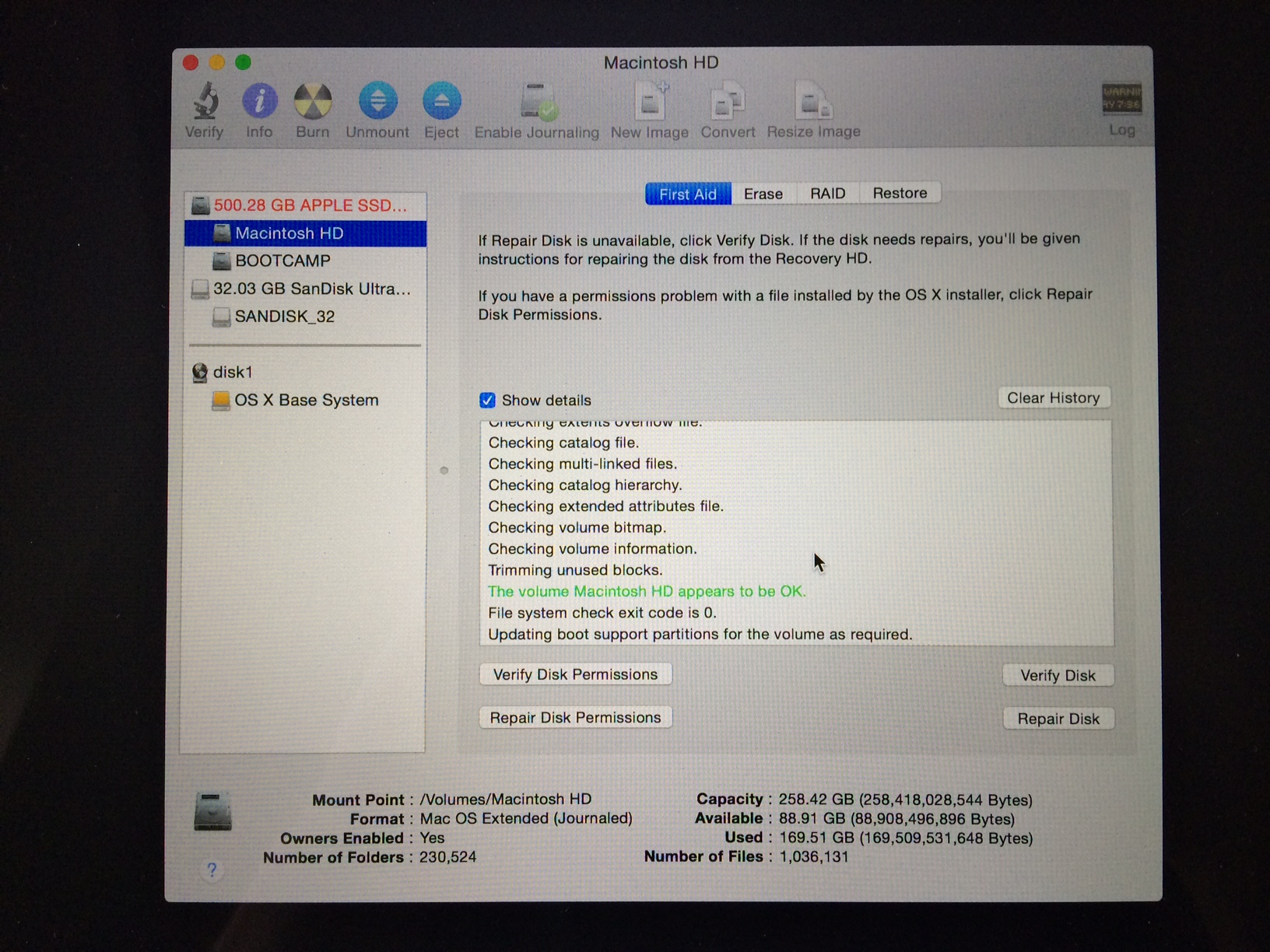

Boot into recovery mode, open Disk Utility and then run First Aid. It will check the disk and try to repair any issues.
Done. No erros found, but smart error still there. I think SMART errors are hardware related, so disk utility or other app can't repair it.
Select the drive (500.28GB Apple SSD), not the volume, and try again. SMART values are certainly hardware related, but the thing is that the WLC simply cannot be correct because the raw value is astronomically high.

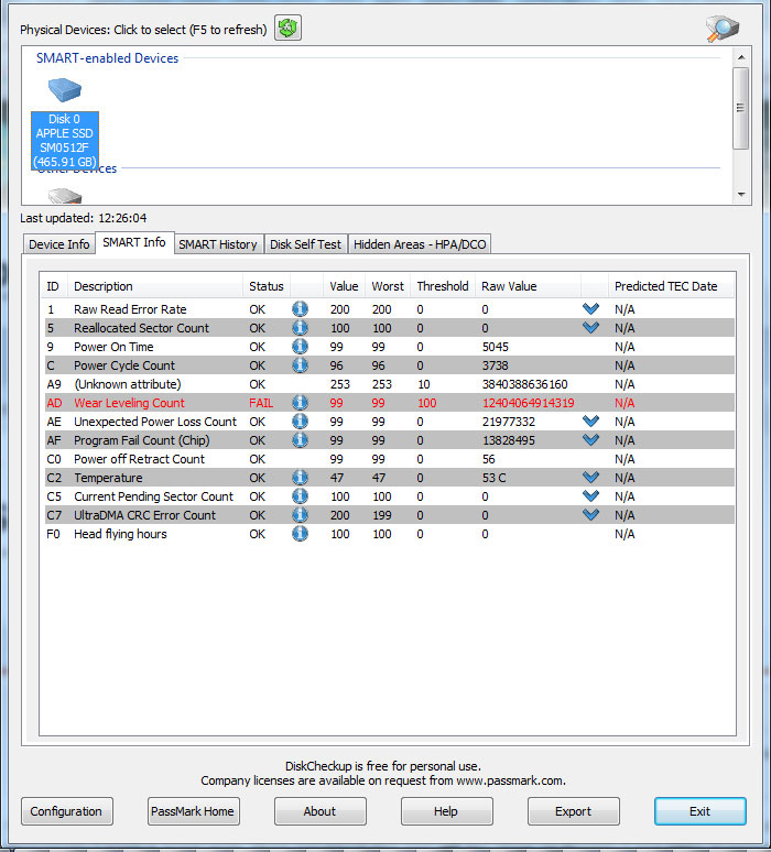

I dont have enabled options if I select the drive. I think the raw value is NOT astronomically high, probably 12,4 TB..
As I mentioned, WLC refers to the number of consumed P/E cycles. That means you have overwritten the whole drive 12 trillion times...
Since you have Windows installed already, can you install smartmontools and read the SMART values with it? It can also perform a variety of different SMART tests that could be useful in this case.
Just to add, it's command line so the command you need to run is:
smartctl -a /dev/sda
