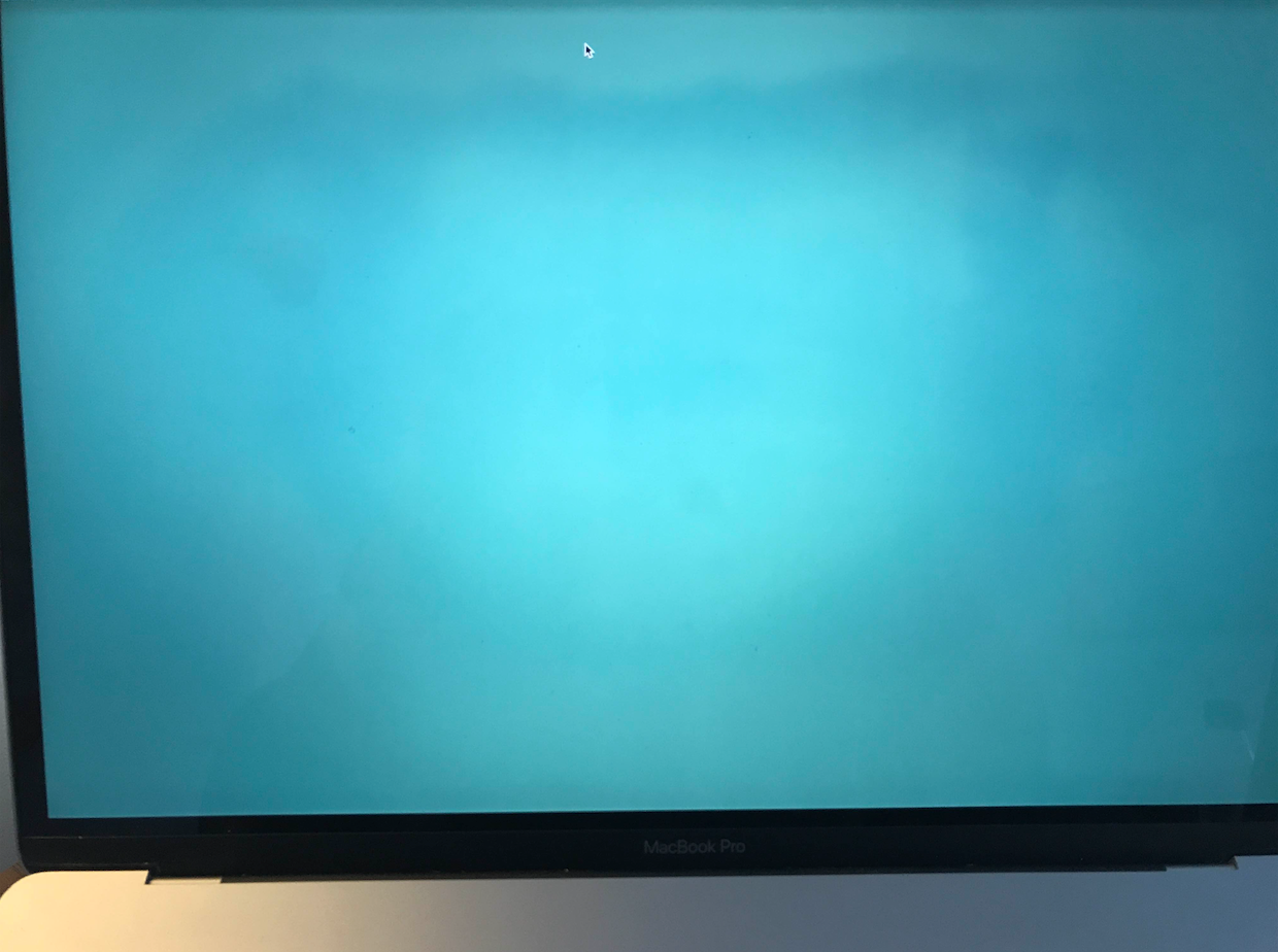

I have a 2016 15" MBP (2.9 Ghz, 16GB, 1TB SSD). I recently noticed regions on the screen that are darker and different from the rest of the display. They are kind of like "stains". They form a semi-symmetrical circular pattern in the middle of the display. A screen grab does not capture the effect - unless it is being looked at on the display of the MBP. External monitors do not display the anomaly, suggesting it's the actual monitor and not the video hardware?
I have Apple Care but am in the middle of a big project and am waiting to finish the project before I contact Apple to get them to fix it. Does anyone else have a similar issue? It's quiet annoying, especially for how much I paid for this machine....

Here is an image. Not sure how this could be a "user fault this one" as you proclaim.
It seems to only be noticeable when the background is a solid color.

Wow, it looks like you took a picture using flash. That's a huge variance in brightness. Haven't seen any brightness variances like that since the white spots epidemic that afflicted the late 2003 Aluminium PBG4s (Apple did a warranty extension for that issue).
Just to be clear I'm not saying flash was used. The center being so much brighter gives it that affect to me.

It's even clearer to see in person, it's hard to capture it with an iPhone camera. And yes, I can confirm no flash was used.
So it sounds like this is different from what others have seen, and should be taken care of by Apple?

@New_Mac_Smell Here is an image. Not sure how this could be a "user fault this one" as you proclaim.
Having seen the image, I have indeed seen computers resembling this particular problem before. Most often it is the result of liquid damage or improper cleaning techniques. If this was present from day one, it is a return, if it has developed, you need to request counsel with Apple to discuss repair options. It is most likely a screen replacement, as long as it hasn't been caused by yourself.

@Rocko99991 - just did the chat. They had me confirm that it persisted after resetting the NVRAM and is also present in recovery mode. They told me I will have to bring it into a store to get it repaired. I will have to find a convenient time to be without my MBP for a week and then take it in. Thanks for all your help. I'll follow up once it's all concluded.
