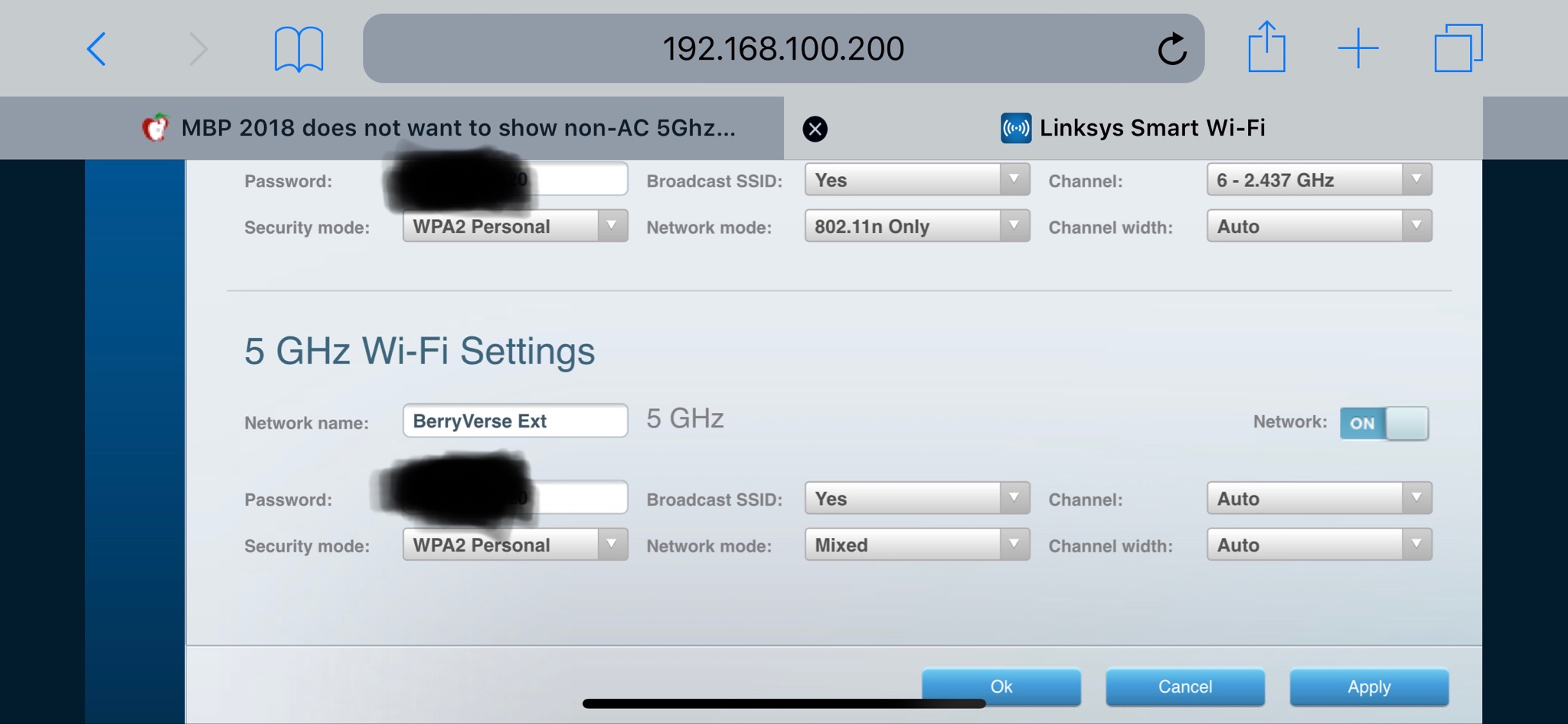

Please can you post a screenshot of the router wifi configuration page.
Which router is it? Is it possible that it’s draft-n? Does the router have the latest firmware?
I am not sure if it is draft-n or not but all my other devices including the 2011 MBP have no issue connecting to it. Even the 2018 MBP connected to it but only when I gave it the same SSID as the AC WiFi and went out of the AC WiFi range.
I am using Linksys EA4500 (N900). Nothing special regarding configs.

So I'm not sure it's totally adding, up, but maybe you can clarify.
Your MBPro cannot see the BerryVerse Ext network (5GHz 802.11n) but if you rename the 5GHz 802.11n network to match your 802.11ac network, it will connect. Not to ask a stupid question, but to ask a stupid question, how do you know that your MBPro is connecting to the 802.11n network and not the 802.11ac network if the names are the same?
The EA4500 is proper 802.11n, not draft, so you should be ok. I would check the firmware all the same. If you're in the US it looks like it should be 3.1.7.
I would also force the network mode to 802.11n (not mixed), and set the channel and channel width manually. Just pick a channel at this point, doesn't matter which, can be adjusted later. And set the channel to 20MHz. Ideally you want 40MHz, but let's try 20.

1. Regarding the Edit. I understand you want me to go through this to have the MBP save the SSID details so it auto connects. It already does as it pulled the entire known WiFi list from my iPhone (iCloud) and BerryVerse Ext (802.11n) is already set to highest priority yet it never connected to it but once during the setup.
2. I have the first revision of the hardware so the latest firmware is 2.1.42.183584
3. I tried many different configs over the night, from 20 only, 40 only, all available channels and nothing. The MBP just hates this router for some reason.
4. I am not quite sure it was connected to the 802.11n. All I know is that I clicked Options(alt)+WiFi icon in menu bar and it said it was connected to a 802.11n network with a decent signal when I was at a far distance from the AC router. (In the past day I noticed the MBP will connect to the AC router on 802.11ac regardless of signal strength even if it ends up with a slower sync speed than using 2.4 GHz.
I will try to reflash the firmware on the router again and re-do everything hopefully it gets more friendly with the 2018 MBP.
Update: No matter what I do, the MBP will never detect the 802.11n or connect to it automatically. I ended up renaming the 802.11n to use the same name as the 2.4 GHz WiFi and when I tried to connect to the SSID it used 2.4 GHz in the first few seconds then switched over to 5 GHz (see screenshot attached).
I think I got my hands tied and this is the best setup for now.
