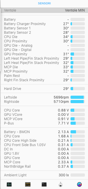

I attach also a little screenshot of istatmenus sensors temperatures.
I suspect a sensor failure, but where is it? I read there are more than 1 and it's not so clear where they are.
