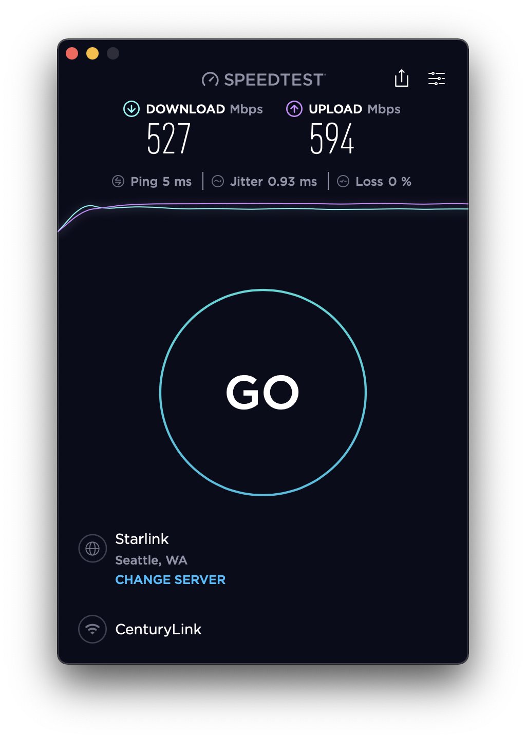

I suspect it's your router or it's config. I'm using Eero pro 6 on an M1 MBP and I can get almost 600Mbps over Wifi.
edit: On a good day I can get a lot closer to 600 down.
