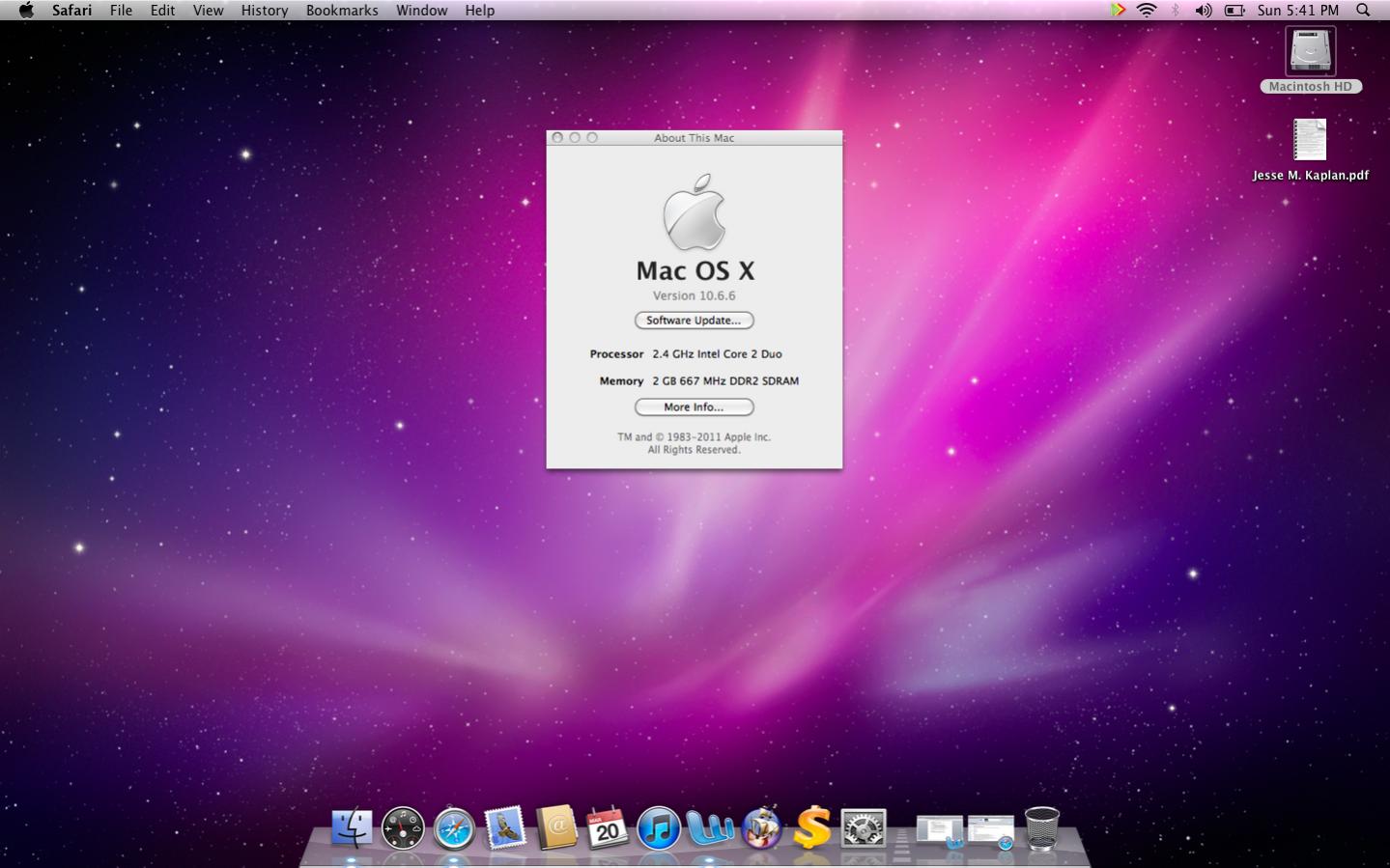

Take a screenshot of your About This Mac, just to make sure. If you have an early 2008 MBP like it sounds like you do, then you must use DDR2.
Sounds like you have an SR (Santa Rosa) machine, which was like late 2007/early 08". If your machine is all silver, than DDR2 is what you need.
Screen shot is attached and my machine is all silver. Looks like DDR2 is the right call.

Yeah I apologize as well as hellhammer, I didn't catch that the first was ddr3 either. Yes the new ddr2 is what you need. If you ordered from newegg don't worry about it, they have great customer service.
