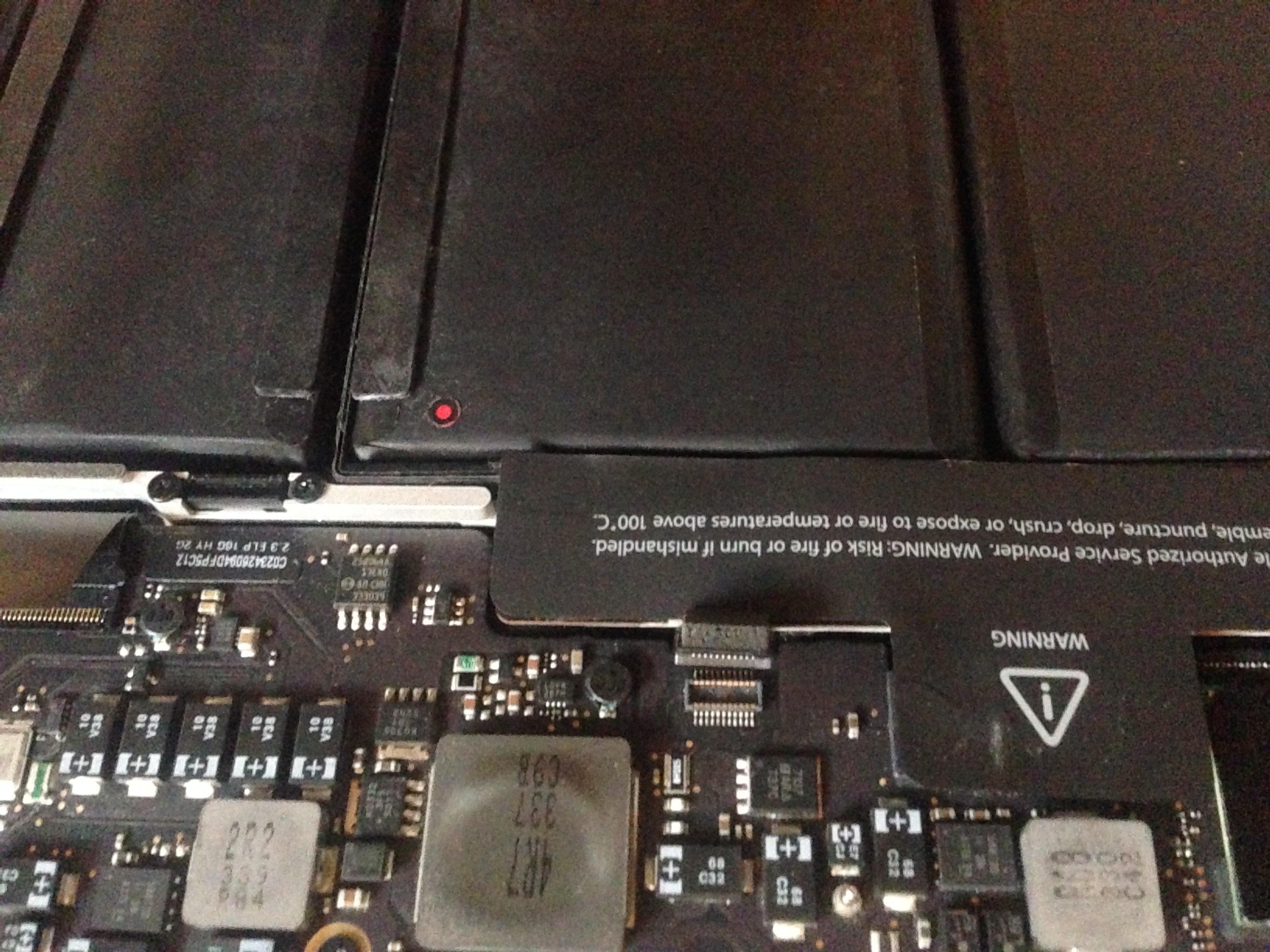

These spots?

Start slow. Spray the cleaner on a tooth brush rather than onto the board.

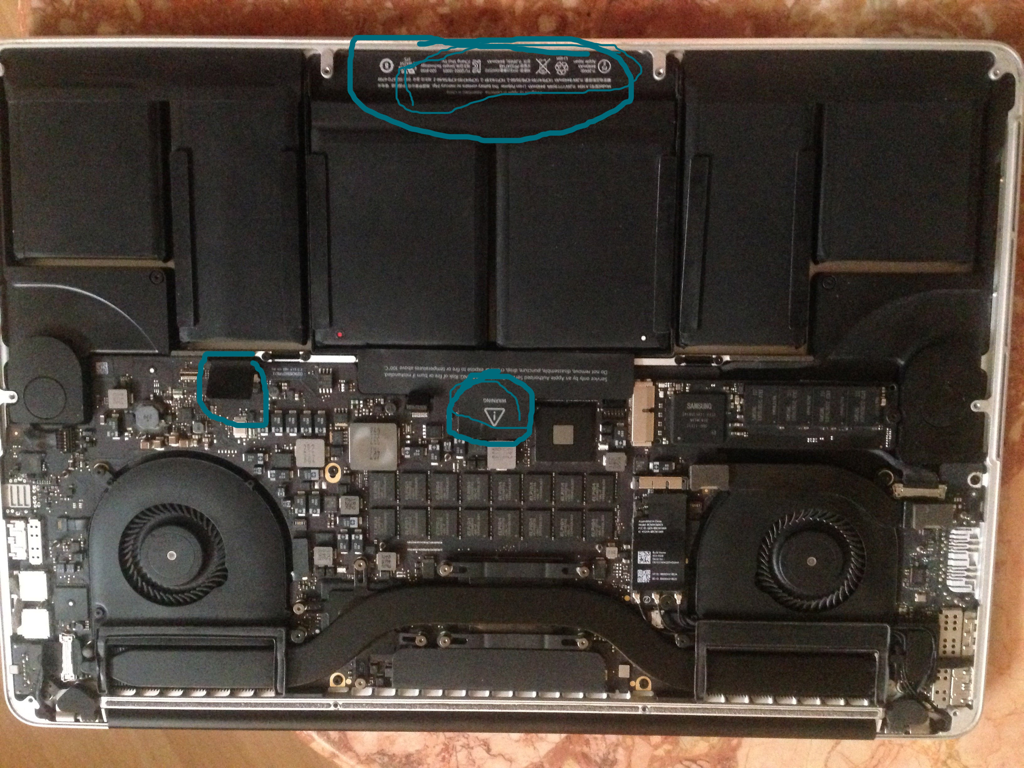

I will try under where the triangle is then - i will use something to get the socket to pop up.. that area is the only one needed correct? =)
I tried taking the battery socket out of the logic board and cleaning it 2 times with some alcohol.. it looks clean.. I havent cleaned the whole logic board not sure if I need to? Are there any other particular areas I should try to clean? or I have to remove the whole logic board and clean it from the upside (keyboard side)?
