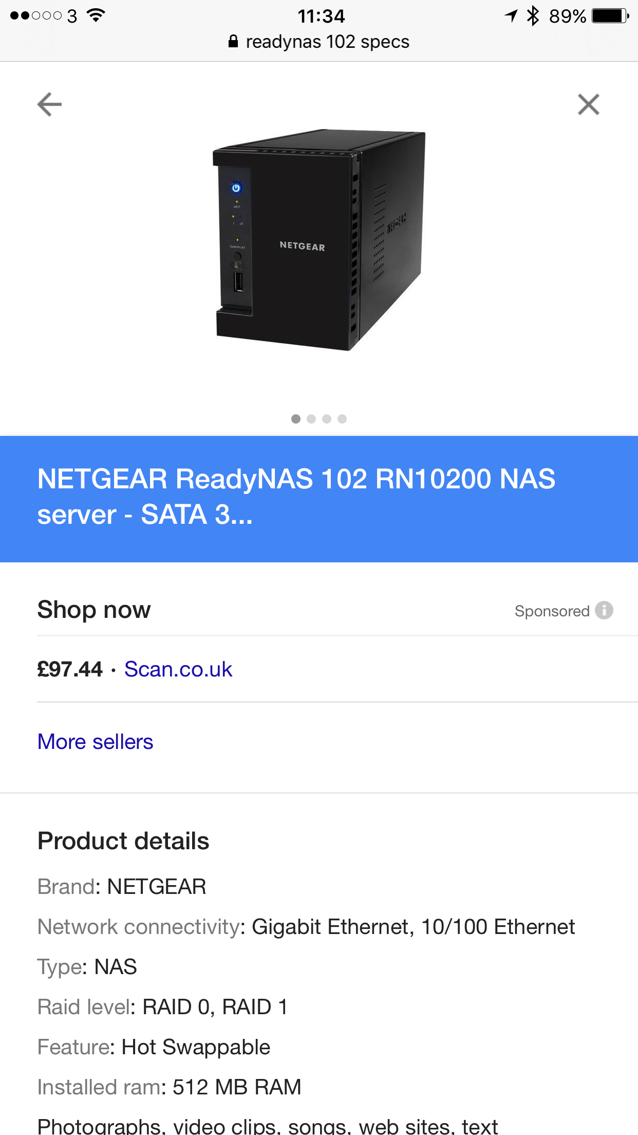

Sorry I've just re read your op. Readynas 102 as in the one pictured?
looking at the reviews for it. For smaller file transfers the speeds are slow. Even large file transfers are poor
