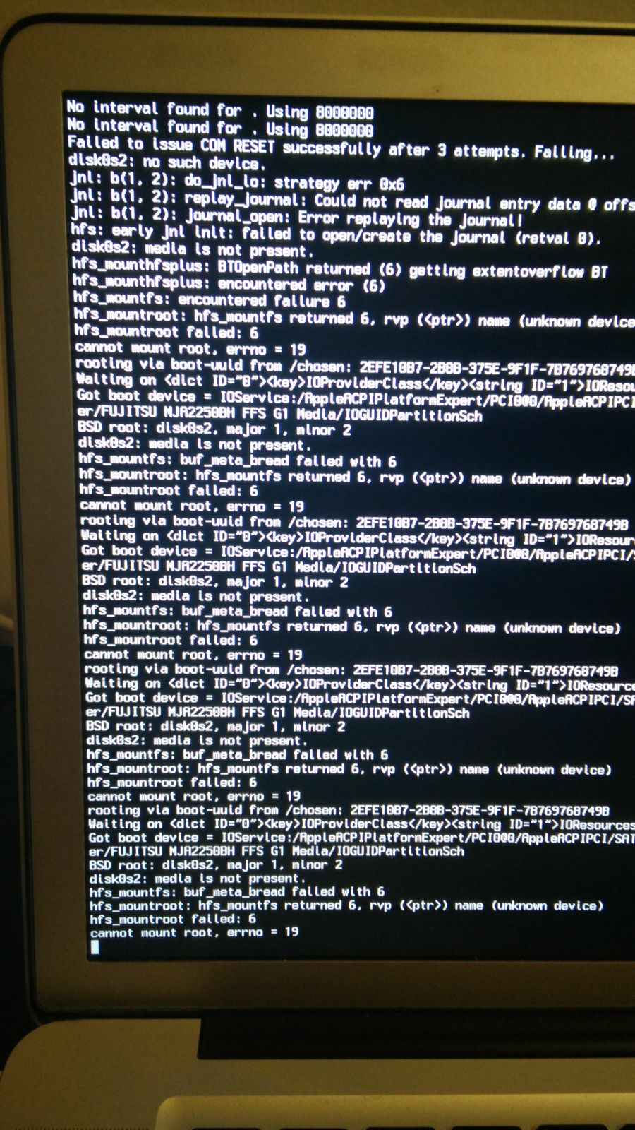

My mid-2009 mbp started to crash/freeze randomly a few times the last week. I ran a disk utility check when I still was able to boot and it said everything was fine. The next day it crashed again, and I haven't been able to boot it ever since – now two days ago. It boots and gives me the prohibitory sign.

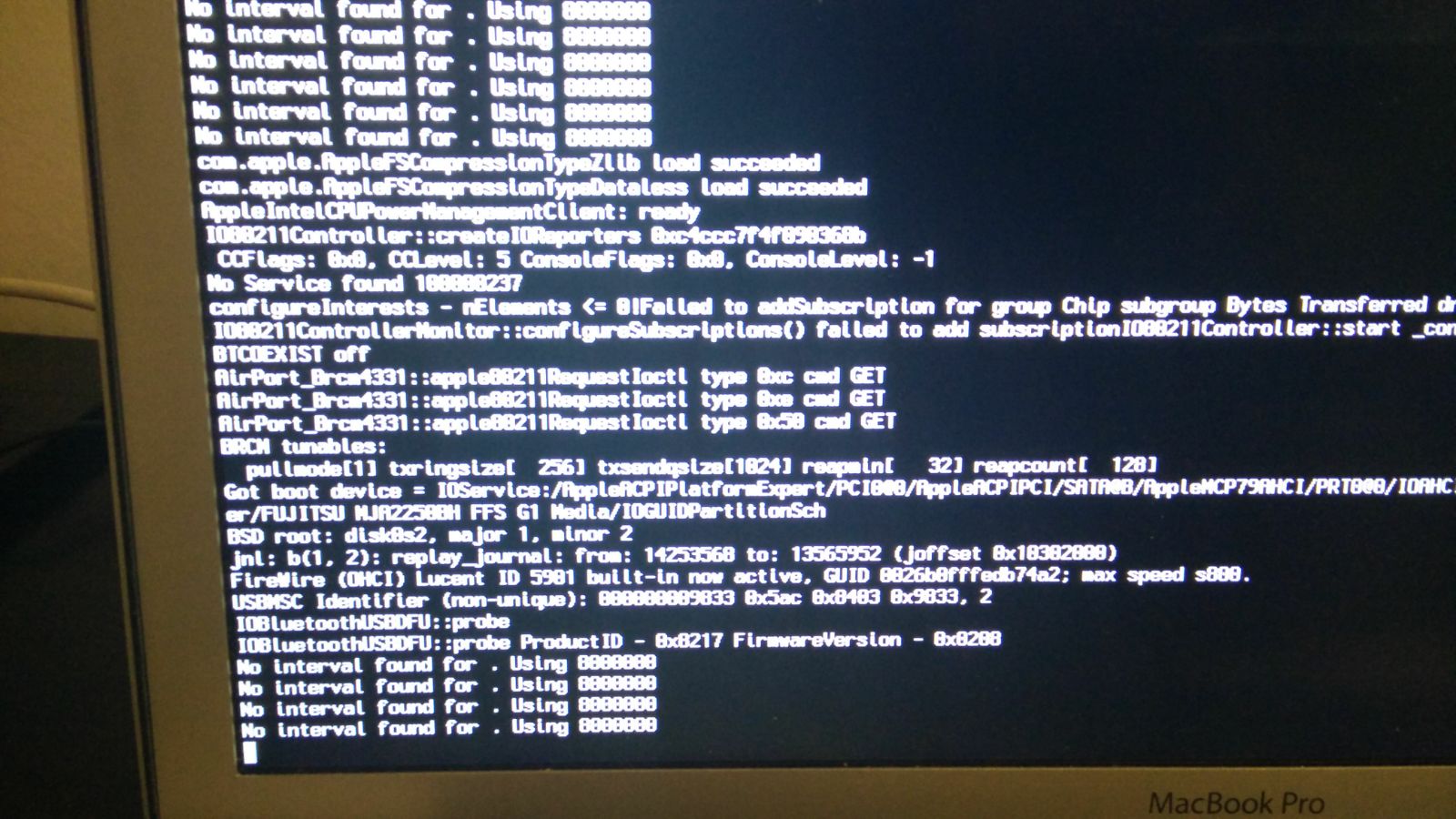

Clearing the PRAM & SMC doesn't help, I can't seem to boot in recovery mode or safe mode anymore (just boots to prohibitory sign as well) and when I boot in single user mode I get these screens:
First this for half a minute or so:
Eventually coming down to this error 'cannot mount root, errno = 19'

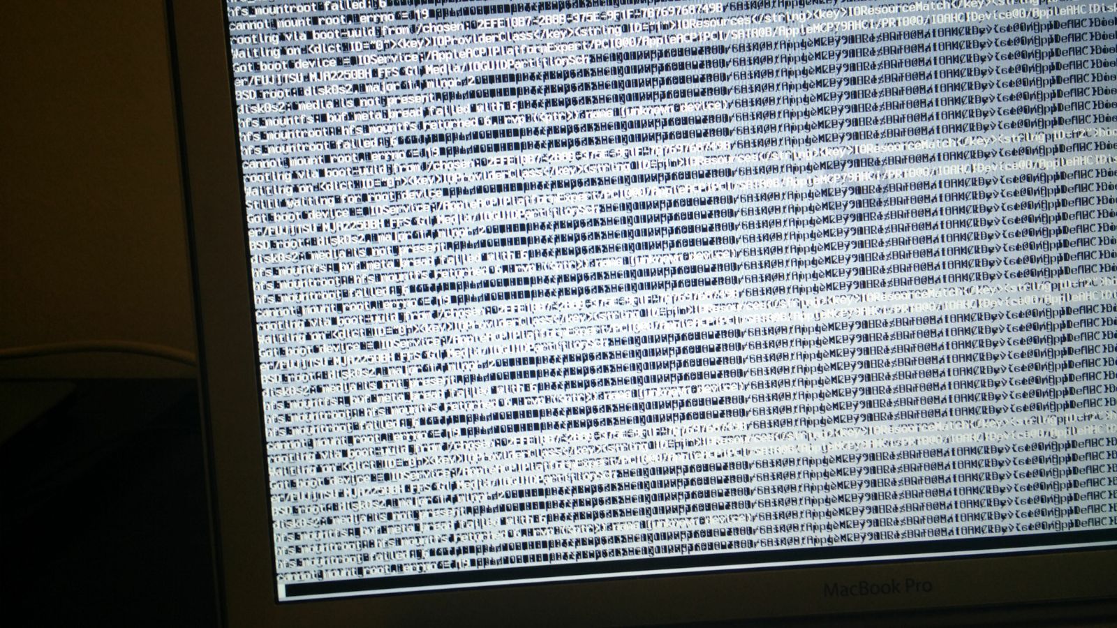

Which eventually leads up to this unreadable mess:
So, what could this mean? Is my HDD dead or could it be something else? If it's 'just' my HDD, I can put in a new SSD and install my most recent time machine on it, I guess.
Or could the problem be something else? Wouldn't want to replace the drive to end with the same issue ...

The problem is likely the HDD. It could also be the cable. The Disk Utility check isn't very thorough - a disk that's about to fail can pass the check. If you have a bootable installer which has Disk Utility on it (or better yet, a HDD with the OS on it), you can try to do Disk Repair on it but chances are that the problem will recur. The only way to know for sure what's going on is to replace the HDD and/or cable with known working parts and see what happens. If you don't have a spare HDD, then you will have to get one (ditto for the cable if the different HDD doesn't work). You might not want to spend money for this without 100% certainty, but the cost of having somebody check this out is likely to be more than the cost of the HDD (I don't think the Genius Bar will do this for a 2009 MBP). Of course, if you have an acquaintance with the spare parts, that would make things easier. One thing you should not do is use your Time Machine disk as your test HDD.
You might just want to go with the SSD anyway, buying it from a retailer that has a good return policy in case there's some deeper issue with your MBP. However, with the 2009 MBP, many models won't work at SATA2 speeds (or at all in some cases). There's a recent thread on this where I share my thoughts.

Sounds like the internal drive.
SSD ought to fix that!
Be aware that sometimes the fragile ribbon cable that connects the drive to the motherboard can wear out, as well. Check it carefully while the MacBook is opened up.
If you put a new SSD in, and you're STILL having problems, you could try replacing the cable.
If that doesn't help... well... at nine years old... it's time to start looking around for something new.
