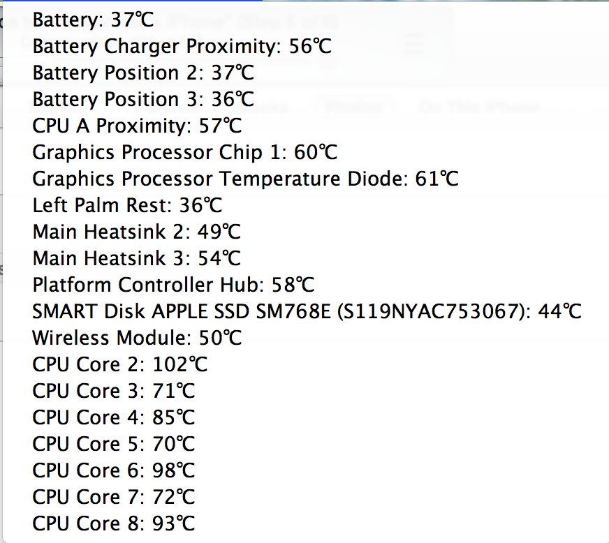

I did the SMC reset, doesn't really make a difference.
Thanks,

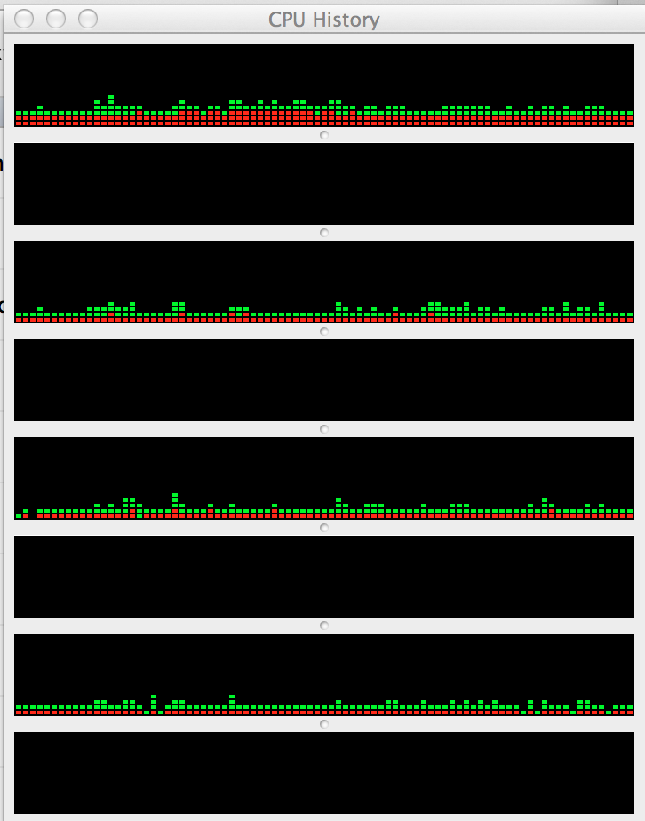

As you can see, there is no heavy load at all. Despite of that the temperature goes sky-high. Once I do my work on my MBP (CAD-Design, rendering) it get intensely hot.
Thanks,
That is rather weird, though I must say temps rise very quickly even with 7-10% load across all cores. If the computer is on a cold boot with nothing open, what kind of idle temperatures are you seeing?

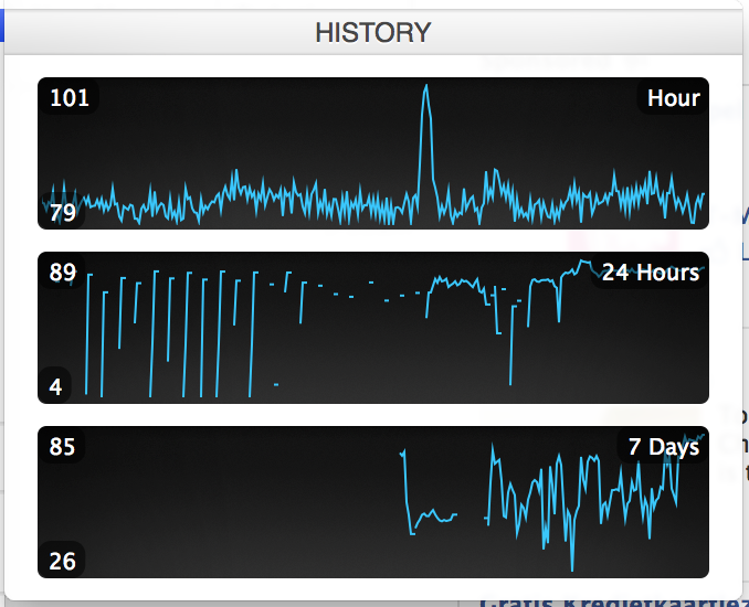

When I open my computer in the morning, after a whole night of no use Temp start idle with 46 degrees Celsius in a relative cold room. After a few minutes of use with just mail and a bit browsing temp rise very quickly to at least 60 degrees Celcius to get even hotter over time.
Here i have a log hystorie of my temperature. Average is around 79/80 degrees Celcius with a small peak when I seriously use my computer.

I used the Istat temperature monitor app. It shows under the "CPU" icon on the desktop bar which videocard is currently being used. Also it allows you to manually speed up your fan's. A very nice app I can highly recommend to everyone.

Found it! It was VLC. Thank you very much for your help. I followed your instructions.
It turned out VLC as soon as open, no matter if you play a movie or not, activates the Nvidia right away. The difference in heat is about 15 degrees Celcius. Not thinking about anything, VLC was often left open, caused my computer to heat up significantly.
There is still the problem left with the Magsafe connector that get very hot, but I guess that is a contact problem, and I will contact Apple about that for a new charger.
