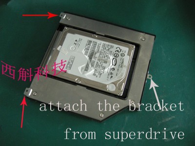

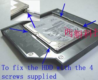

Uses all the mounting holes.
Probably the most "legitimate" one yet, since this one actually is specific for the Mac. All the other ones seem to be overpriced caddies that are $13 on eBay.

Just chiming in to say that I bought the "OBHD9-SATA-SATA-BV" caddy from newmodeus and had zero issues. Was able to reuse the two removable brackets from the Superdrive and the caddy is held down quite snugly.
