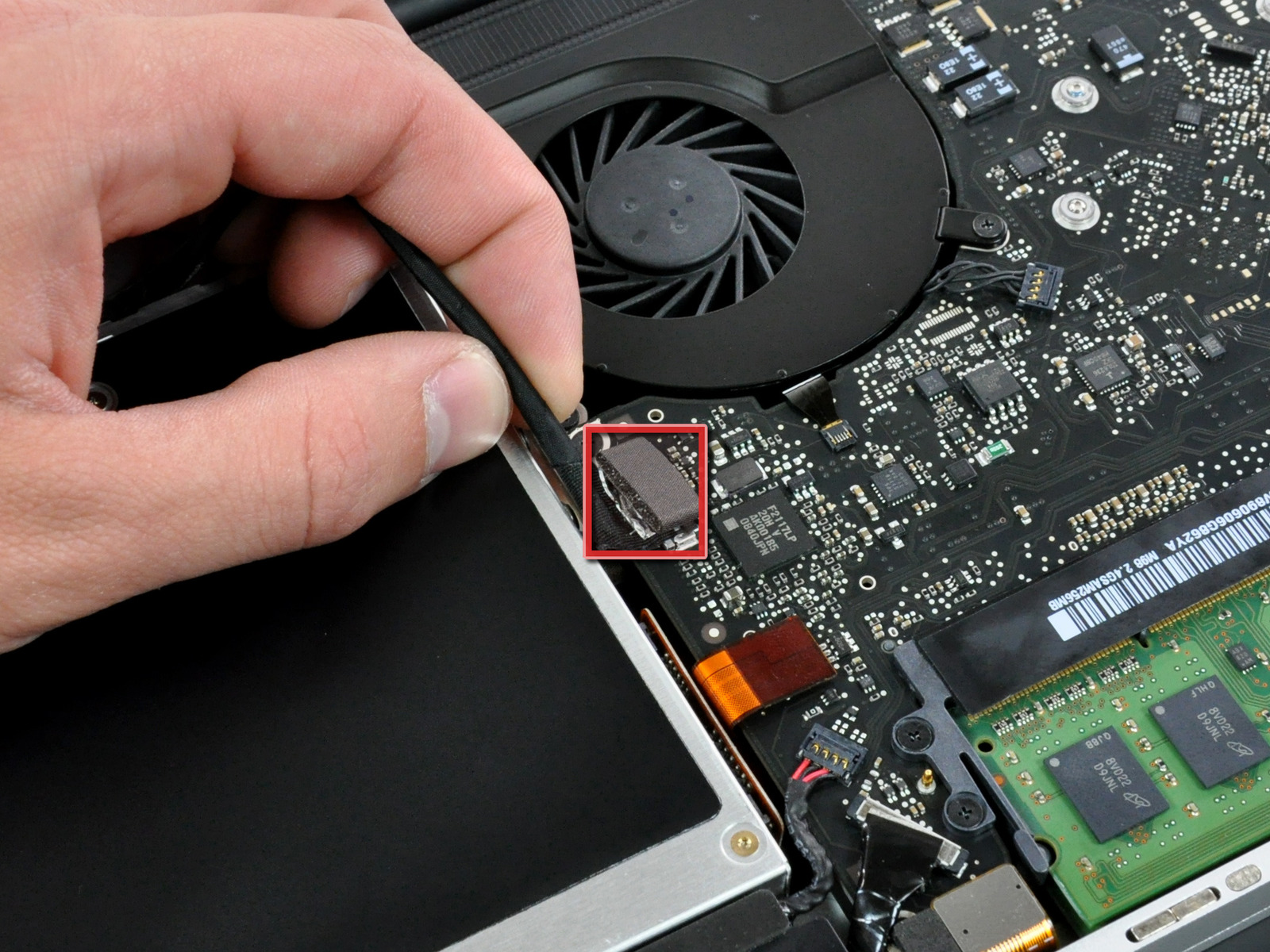

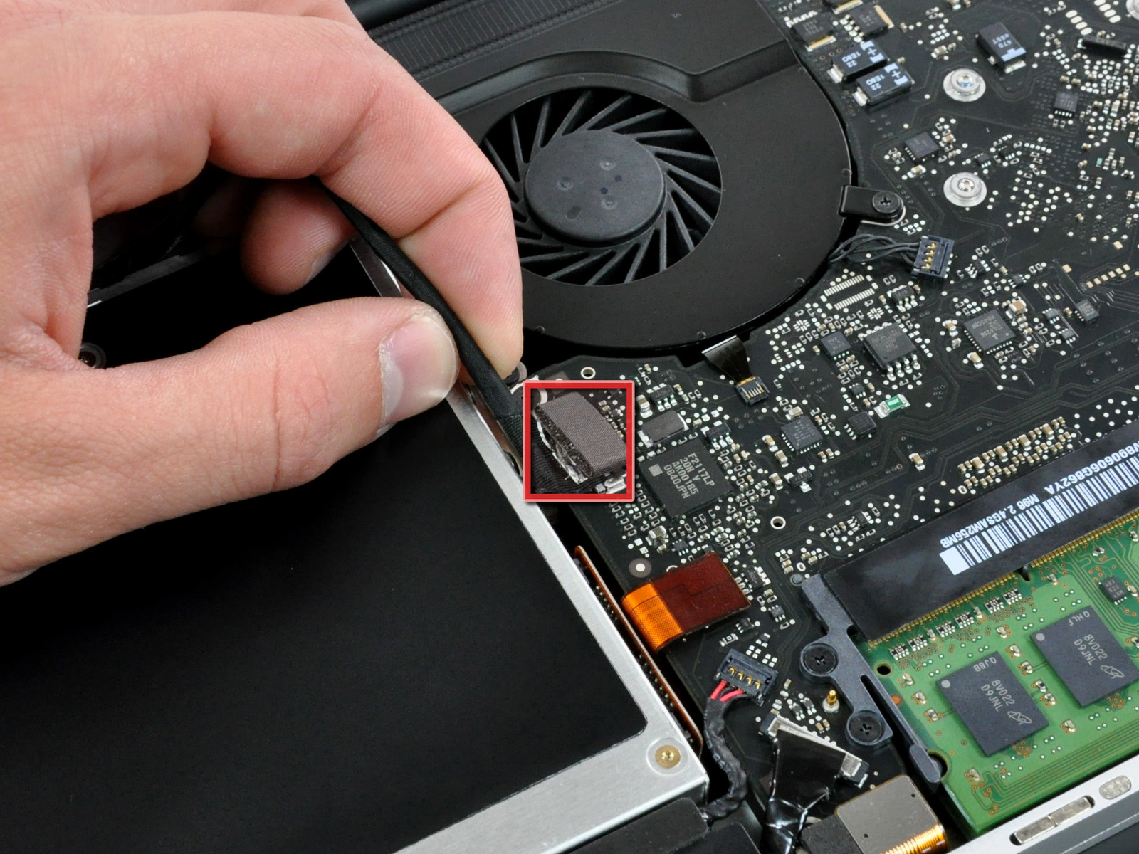

careful when doing this the true modder way, as the OP did. I just did it with mine and apparently jacked something up with the ribbon cable connecting the camera. That cable must not just be for the camera as my bluetooth and backlit keyboard no longer function either.....😕 any advice? tried pram and smc resets, as well as numerous re-seating of the connector on logic board.
take it apart again and retrace your steps slowly.
examine every plug and make sure nothing has wiggled loose when putting it back together last time.
You will probably find you have either pinched a cable by accident or pulled on one that has resulted in it coming unplugged.
update: have since found out that the backlit keyboard does work. the reason it doesnt work with the f5 and f6 keys is beacause the cable that connects the camera, also connect the ambient light sensor. only way to control keyboard is by running a 3rd party app. I have narrowed it down to one connection, but to my eye it appears to be connected as it was before. The pic is my culprit.

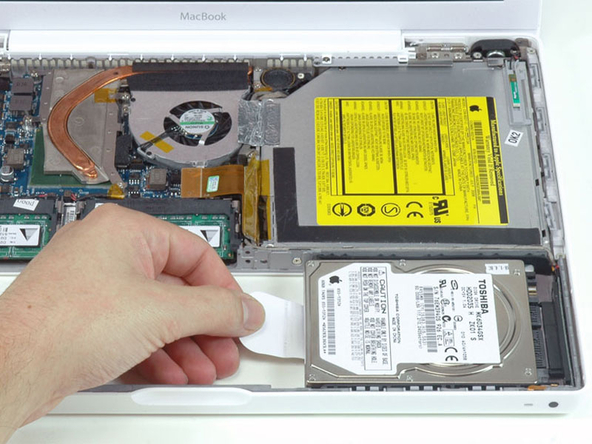

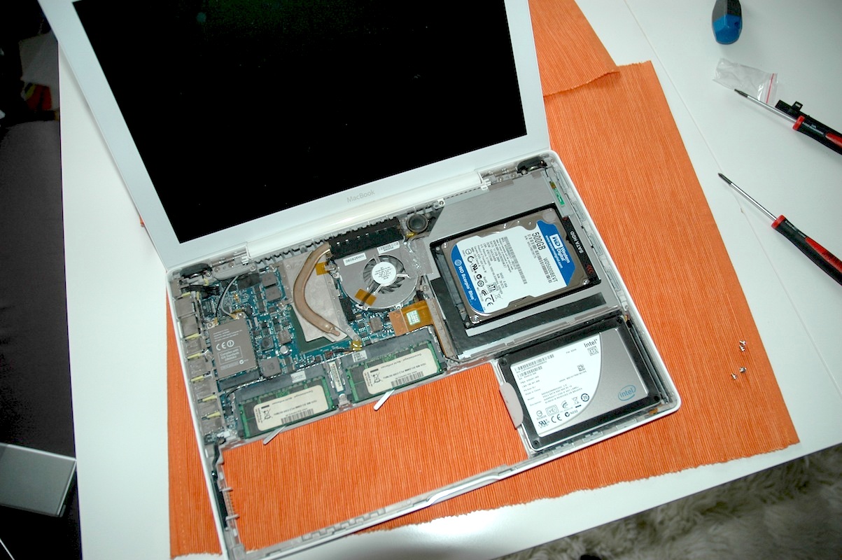

Looks like I'm a member of the club now. 😀 I have to thank all participants of this thread for a lot of useful information 🙂
I got a $20 Optibay alternative from an eBay vendor located in China. They delivered it to Germany in less than a week. The caddy actually feels very high quality to me for the price. It looks nice, feels very sturdy, and everything fits perfectly, with all the correct screw holes installed. The HD is held securely in place by a little holding bracket.
I put my old, WD Scorpio Blue 500 GB, hard drive into the optibay even though some recommend against that, but I'm willing to take the 'risk'. A new 80 GB Intel X25-M G2 SSD is now installed in the proper hard drive bay. Everything works as expected including sleep in all its forms. I couldn't be more satisifed.
Even though the SSD has to operate in SATA 1.5Gb/s mode, my trusty old first-generation Macbook feels like a completely new, super-speedy machine. Highly recommended for anyone who wants to breathe new life into his or her aging Macbook ! 🙂
It might look like it is connected, but it's not. Push it in farther. Try GENTLY pulling back the felt pad on top so you can see when it is in all the way. When I did the mod on mine, I didn't get it in the first time either. Except on my late 2008, that's also the AirPort cable. :O

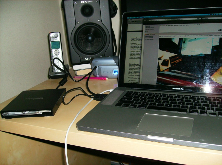

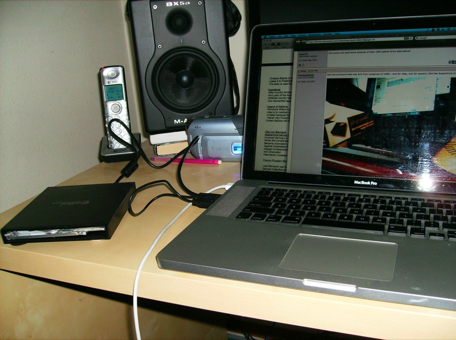

My Connectland enclosure from Newegg. I added some felt pads underneath so it doesn't rattle so much.
