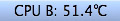

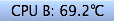

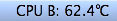

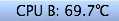

Did you get a chance to redo the thermal compound?
Hi Swampus,
I finally got around to redoing the thermal compound with some Arctic Silver.
Here are my temps. They have increased!!!
CHUD not activated while idle:
CHUD not activated while under load:
And...
CHUD activated while idle:
CHUD activated while under load:
Please note a few things:
- I have an ATI Radeon X800 XT graphics card installed (previously OEM card)
- I have 3 hard drives in the machine (previously just 1 hard drive)
- the ambient temperature is hotter now (summer in Australia). The room temperature was about 28°C when tested.
So this is one hot MDD. It almost hit 70°C! I wonder what the max is before it shuts down?
