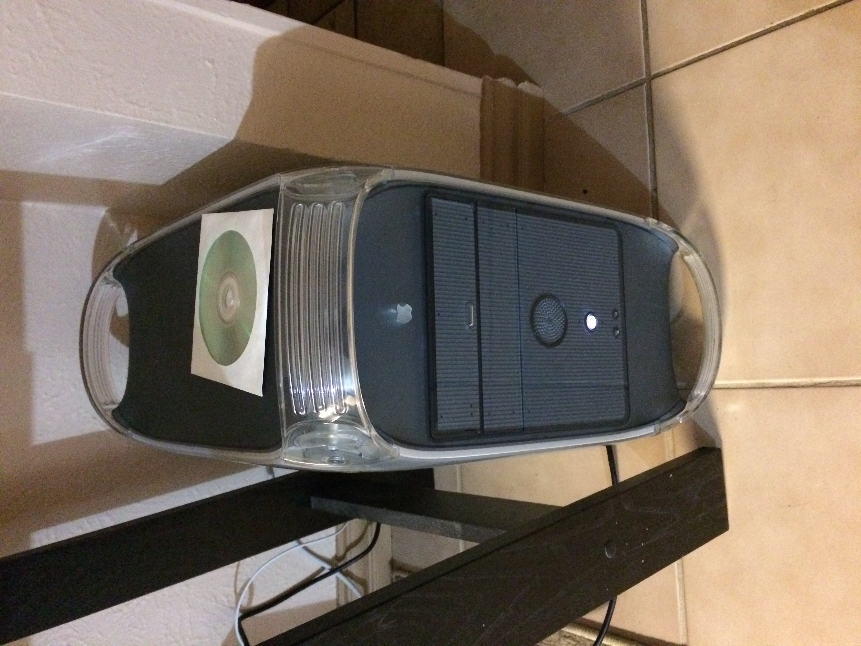

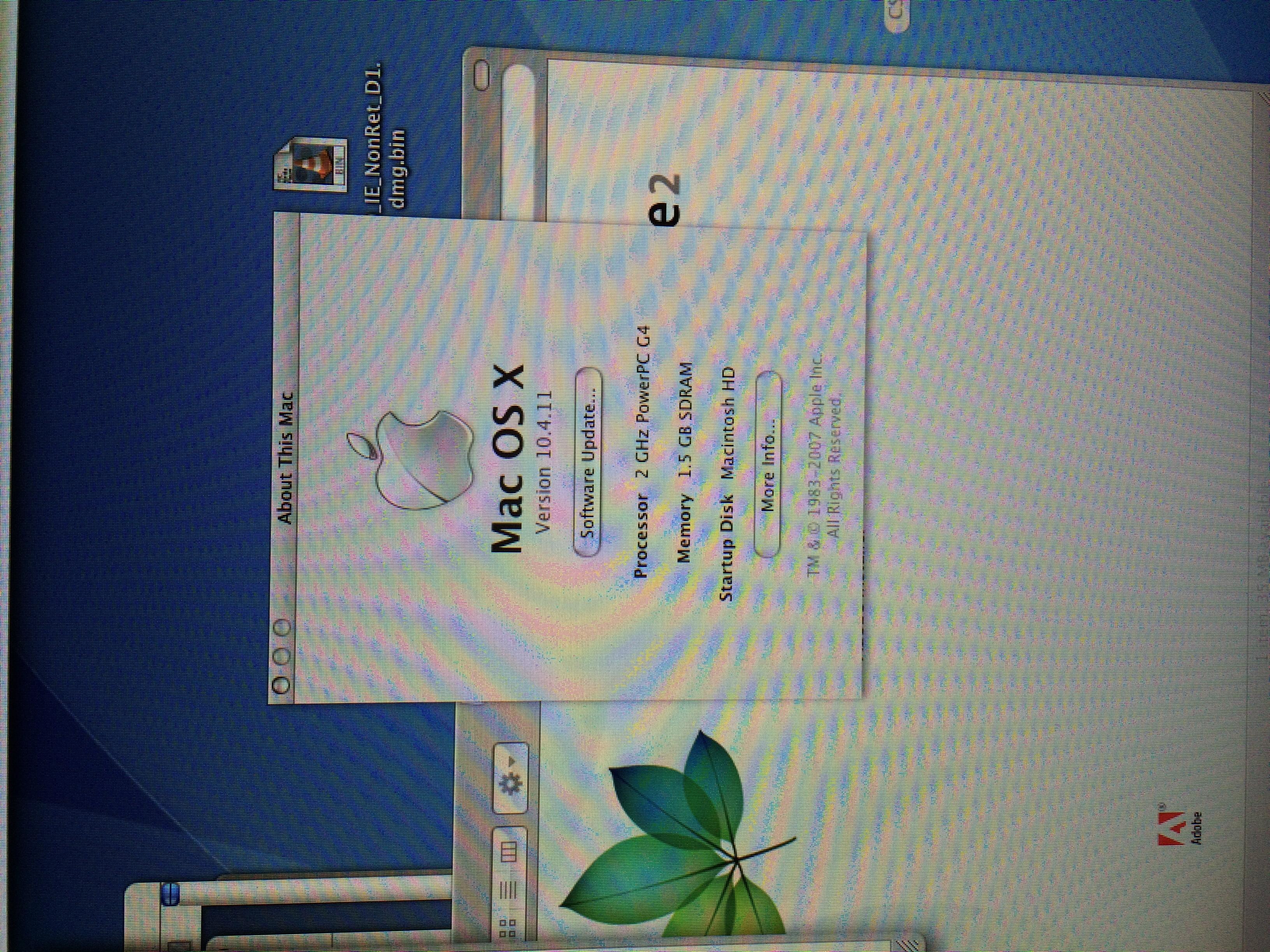

Boy, is this thing a beauty. Digital Audio 466 upgraded with a 2GHz Newertech CPU, maxed ram, and a 128GB SSD Boot drive. It positively sings in Tiger, and when I upgrade its GPU, it will conquer Leopard.
The only downside is that I traded my beautiful TiBook for it. I'm not complaining though! This thing is marvelous.

Very nice!
I'm partial to the DA, as it was my first G4 tower. I suspect it is a screamer with the 2ghz processor.
The only downside to these(and Quicksilvers, which I also love) is that the RAM maxes out at 1.5gb. At least you get the benefit of 133mhz RAM, though.

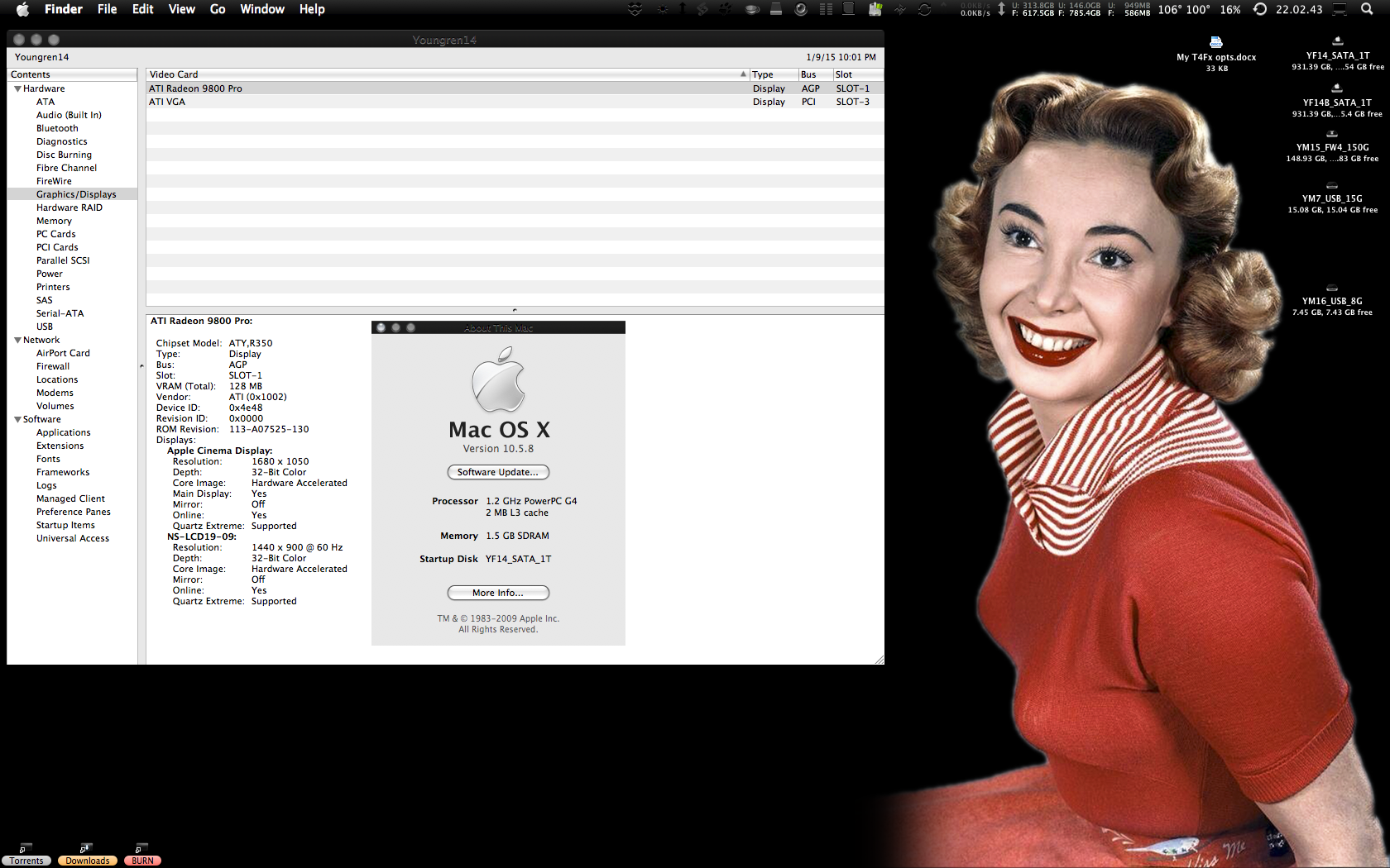

I'm using a 9800 Pro with an A1006 ADC-DVI converter for my 20" Cinema Display. I get all the Quartz stuff, but I mainly have the eye candy shut off for performance on Leopard.
Nice Mac BTW. My QS is using a Sonnet 1.2 (at the moment).

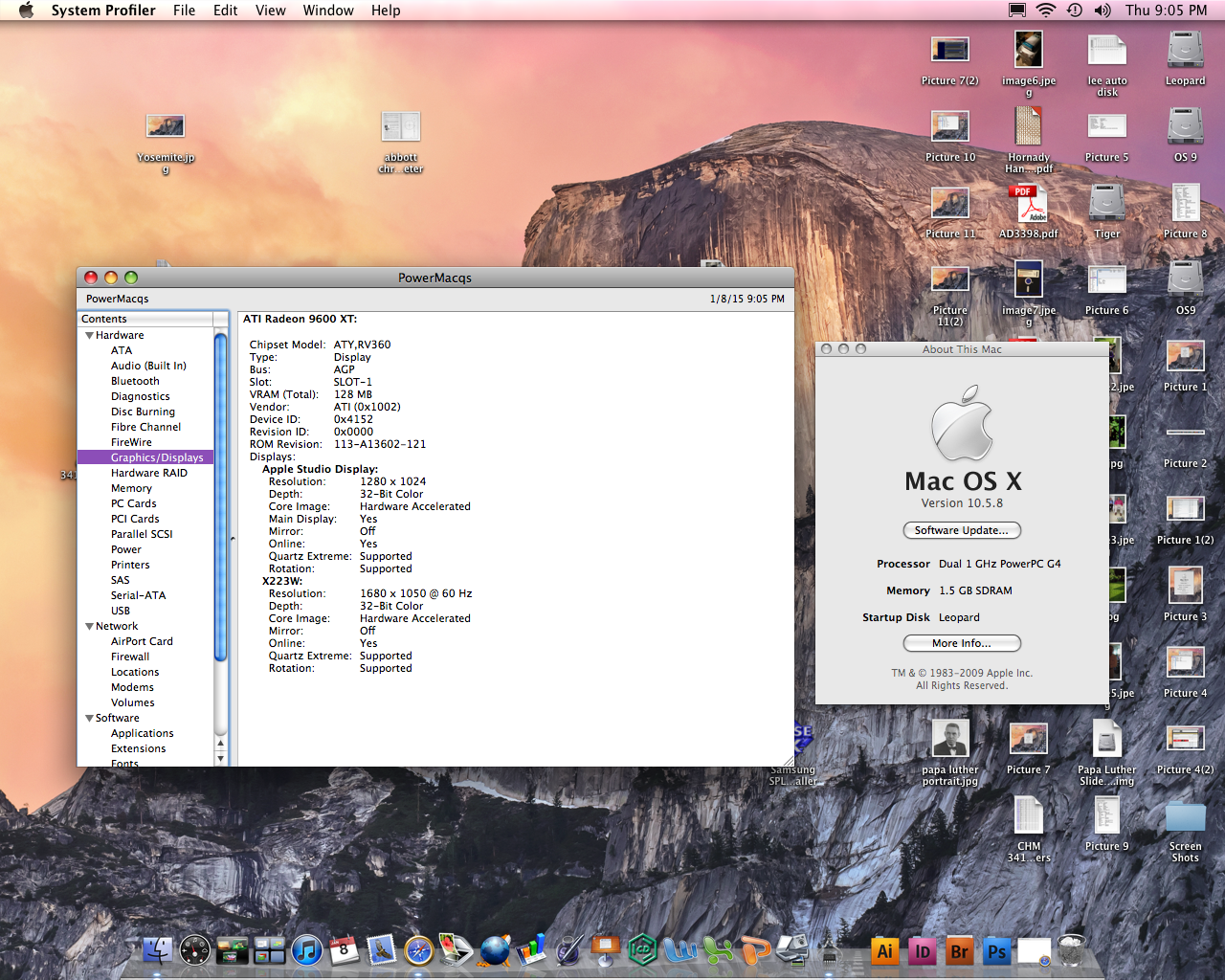

Here's a screenshot I took yesterday on my Quicksilver
EDIT:
It looks like eyoungren posted about his experience with the 9800 while I was typing the above. Listen to him, since he's used the card and I haven't!

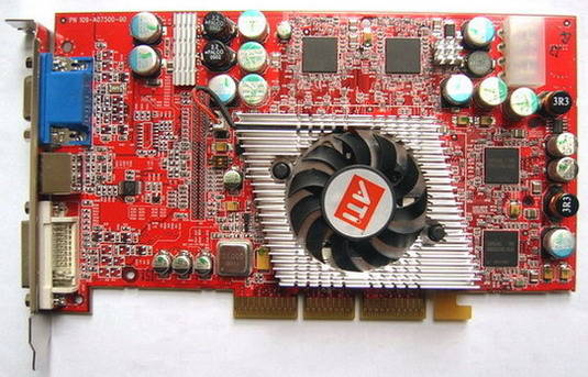

Just to be clear…there is a G5 version of the 9800 Pro that shipped as a BTO option. ATI, however, made a G4 compatible version that was sold retail. That's the version I have.
The one for the G5 won't work in the G4. The difference is that the G5 version is a blue card and the G4 version is red.
Additionally, the G4 version required additional power. There is a Molex connector built into the board. You'll need to have a spare molex connector as power from the AGP slot only is inadequate.

This is my card…
Make sure you search for a Mac version as ATI made both a PC and a Mac version and you can't use the PC version in your Mac. Also, the base version is 128MB, but there is a special edition version (which I will hunt down and dominate at some point) which is 256MB.
I can tell you where to avoid looking though. There is a seller on Amazon that offers refurb 9800 Pros for around $50. The refurbs are cheap (I broke a part off mine just by handling it within 5 minutes of opening the package). The fan on my card died a few months after using it. Fortunately, I had a VGA cooler, but the radiator blocks one of my PCI ports.
So, if you can try and find one on eBay. But be careful because there are a ton of non-Mac ones on eBay.

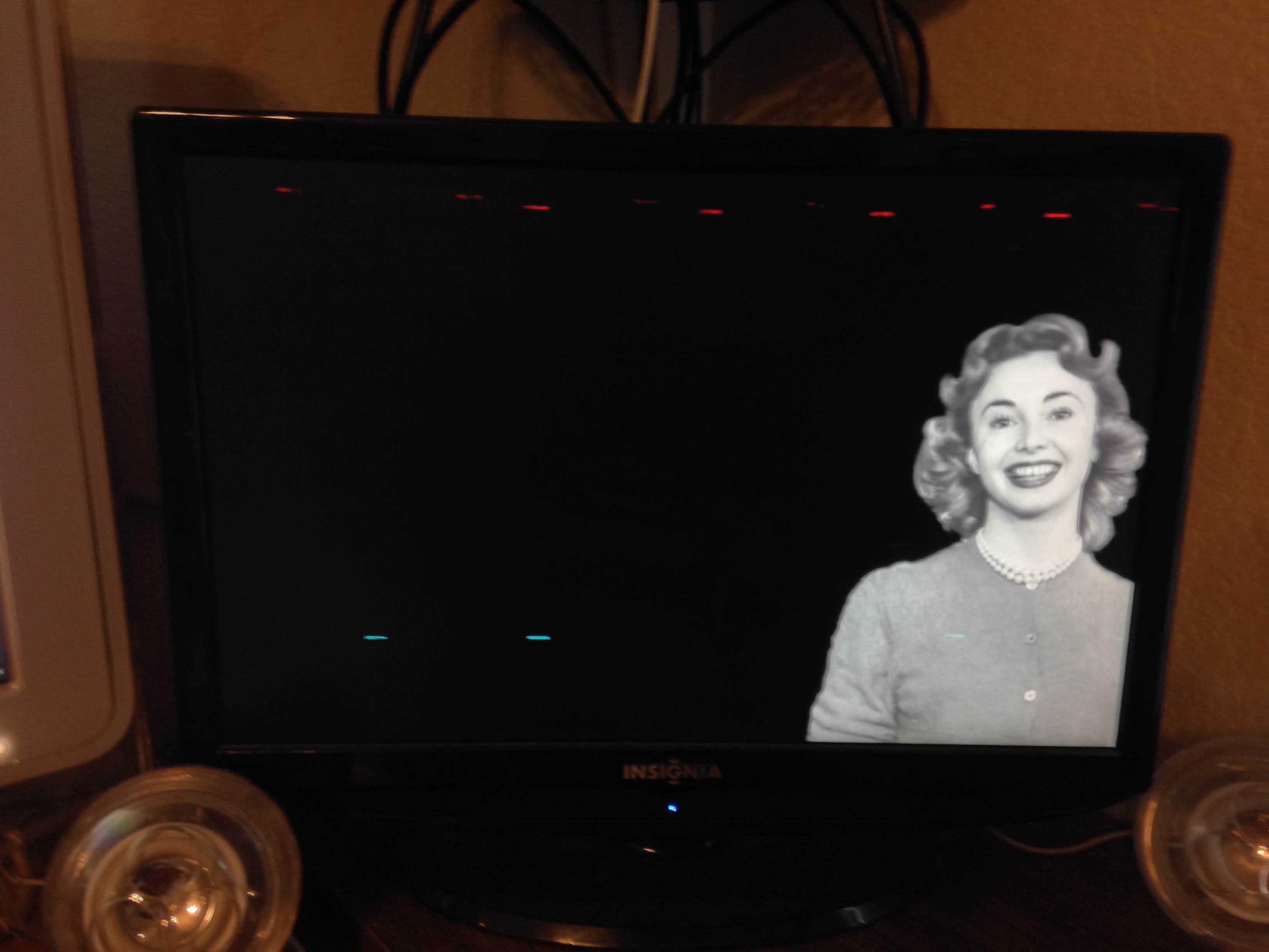

I hadn't heard that (heating issues). However, I will say this. After the Mac warms up I get little artifact issues. Little red and blue garbage lines pop up on the screens. If I move a window over them or change spaces they will disappear for a while but always reappear in random spots.
I have attributed this to that little part that snapped off my board. There is a way to compensate however, and that is to use the ATIcellerator pref pane to underclock the card.
However, given the improved cooling that I now have (I cut a hole in the bottom of my Quicksilver's case and put a high CFM fan there) this artifacting has not been that bad lately, so I have not underclocked the card. So…if heat issues are indeed a problem then maybe my card is ok and that particular part is irrelevant.
Something to consider. I still intend to replace the card with a 256MB version when I can.
Note, I tried taking a screen shot to show you the artifacting, but interestingly enough it does NOT show at all in a screen shot! Very strange!
So, here's what it looks like with a shot from my iPhone.
