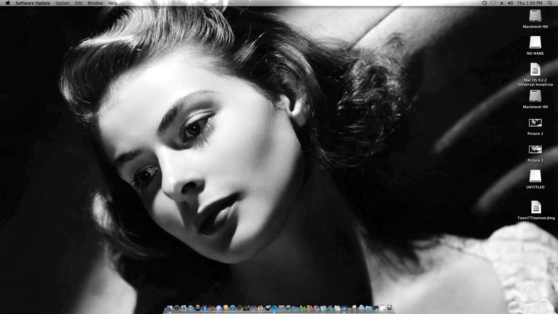

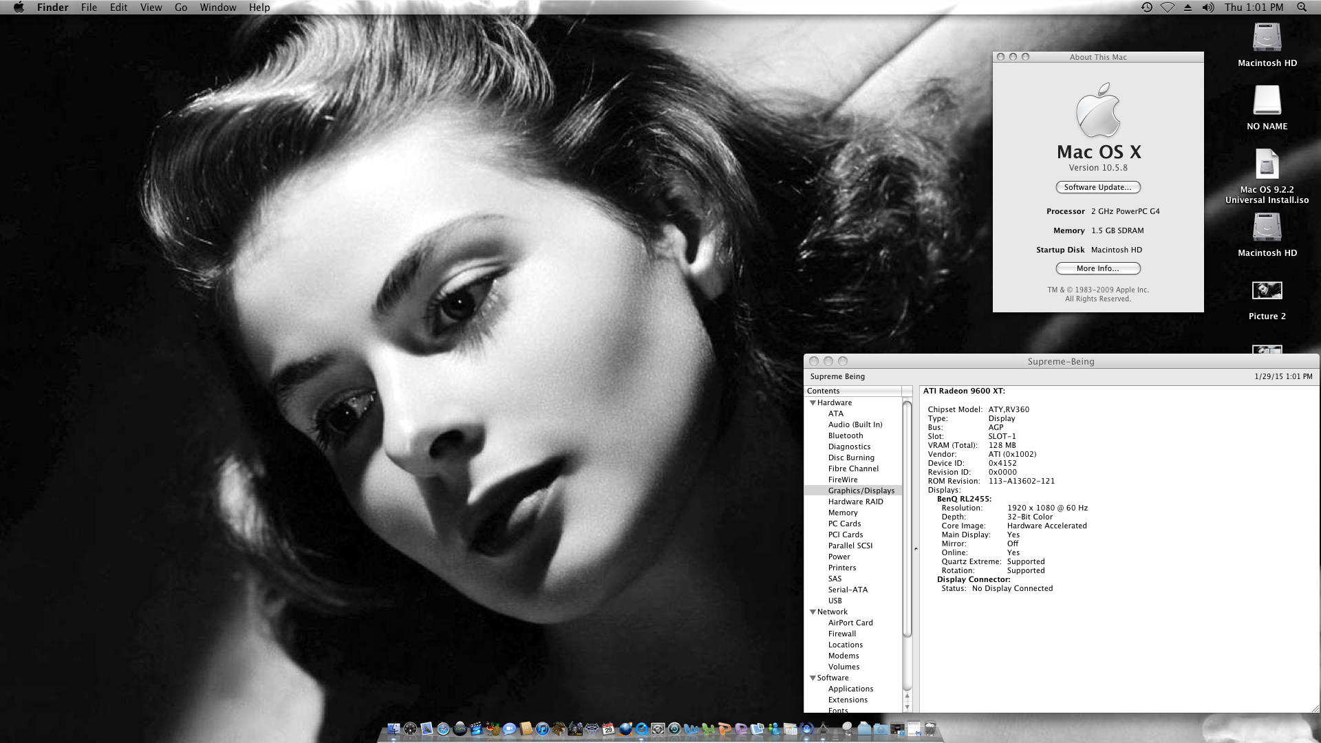

Totally forgot to post these! :eek:
Behold my glorious G4 desktop! Now supporting Core Image and Quartz Extreme! :p
As you can see, I'm a big Ingrid Bergman fan.

Very cool!
I would post my desktops as I'm a big Audrey Meadows fan, but I think I've plastered MR with those enough! LOL!
Looks good!
Awesome machine!!. Love the DAs, not sure why,even with the same CPUs the DAs always seemed a bit quicker than the Quicksilvers
Thanks!!! I love this computer. It's amazing to me how capable it is for something built in 2001.

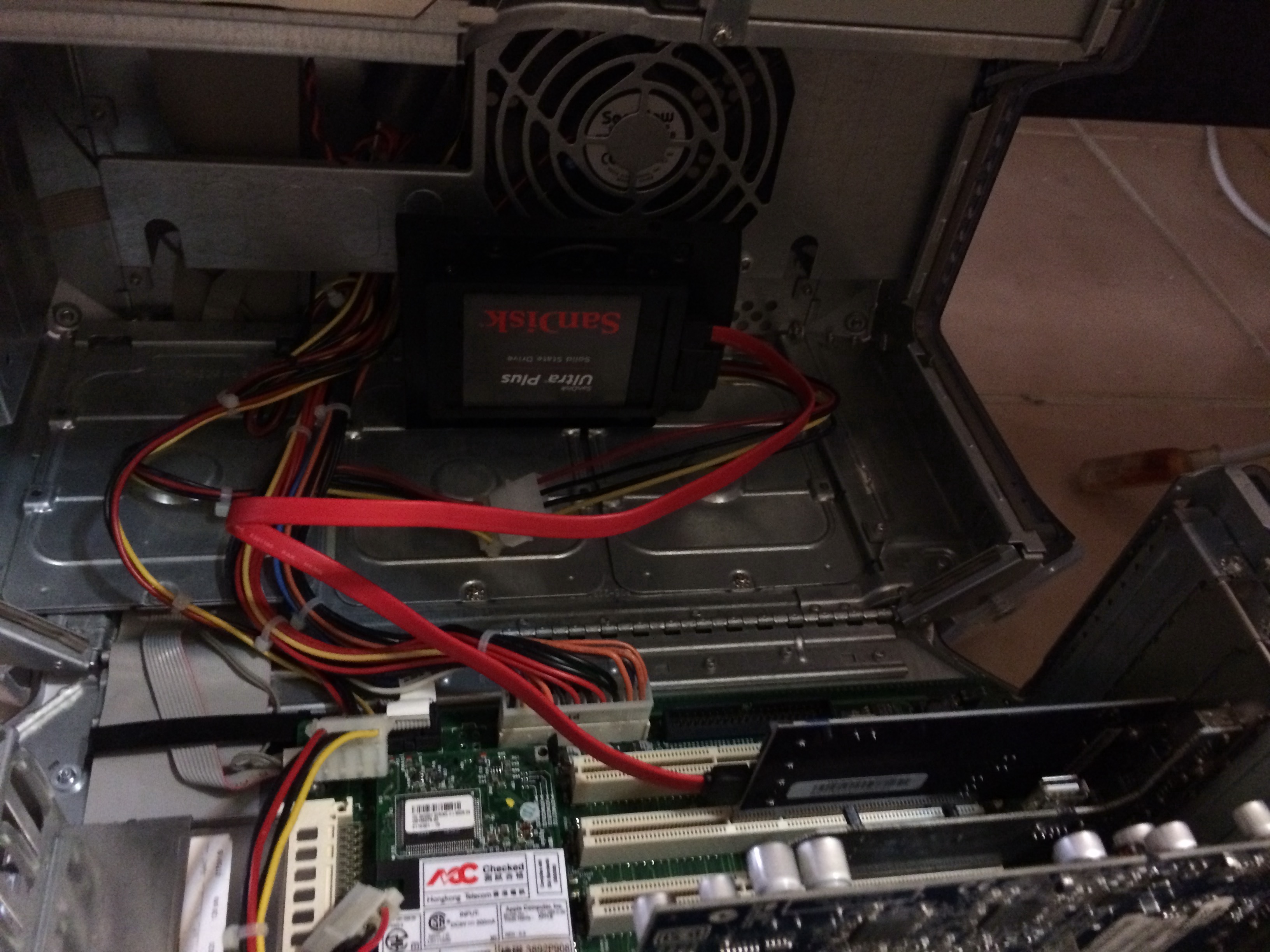

Installed a second SSD on my SATA card (I had an extra laying around).
I had to mount it vertically because that's the only way I could get the enclosure's screws to align with the drive trays. I think it turned out okay.
