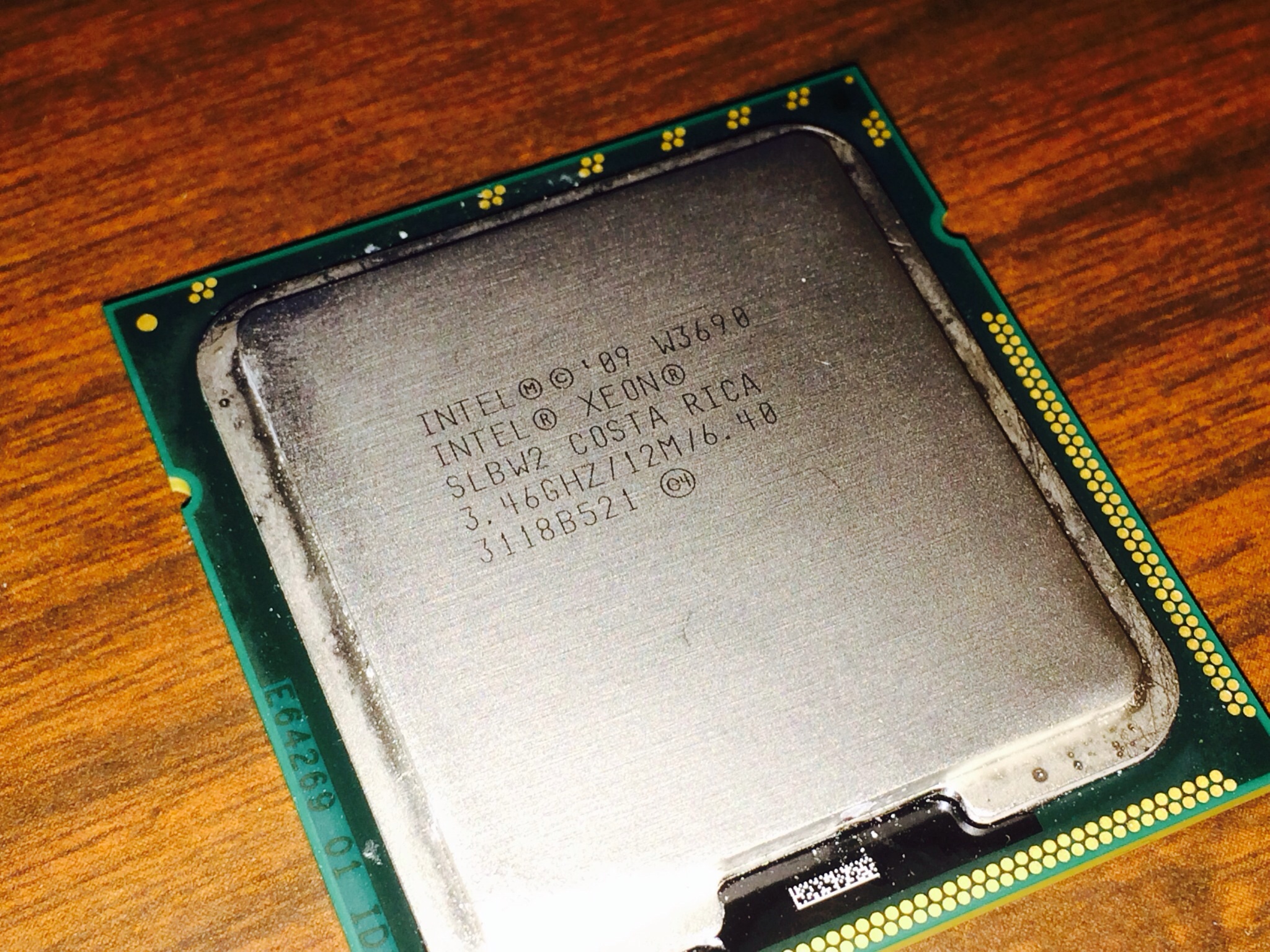

Well can't wait to put this sucker in. Thinking I just prolonged my Mac Pro for another few years.

Very nice!
Went with a W3680 myself last year - hard to come by a reasonable priced W3690.
You'll enjoy processing power that CPU-wise exceed the quad nMP, you'll have a range of different video cards - that beat the video cards in nMP - to choose from, and you may keep most of your disks internal.
Solid for several more years.

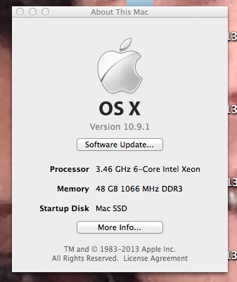

W3690 in my 4,1 Mac Pro
I have 1 stick of 1066mhz memory so the other 2 1333mhz downclock.
Big thanks to 4JNA for hooking me up with an EFI card. The utility wouldn't let me update without an EFI card installed.

Were you never able to get the 5,1 flash working?
I couldn't with the Titans installed and doing it blind or with them removed. The Mac Pro needed an EFI card installed in order for the flash to work I guess.
Popped in the 8800GT and worked on first flash.
Oh, that's good. I'll def keep my GT120 around for times like that.
